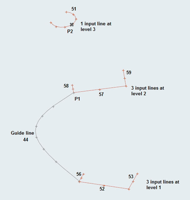

This command creates surfaces by interpolating linearly or smoothly between input lines. Optionally, a list of linking points and/or guiding lines can be provided for better interpolation and shape control. The input lines should be given in the correct order, grouped into ‘levels’ of the ruled surface. For example, referring to the image below, the input line list should first include 3 lines at level 1, then 3 lines at level 2 and then the line at level 3.

- The list of x-, y- and z-coordinates for the optional points which are to be linked by an edge in the ruled surface(s). Link points should be given in pair or points, since each link between input lines is specified by its two end points. When these points are given, the final ruled surfaces include a surface edge that connects these points. Because of that, the pair of points must not skip levels. For instance, in the image below, we cannot skip level 2 by connecting a point at level 1 with a point at level 3. If such a skip is detected, the corresponding pair of points is ignored. One point may be linked to multiple points at a level above or below it, which results in creation of ‘triangular’ surfaces.

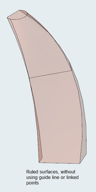

Referring to the images above, to create linear ruled surfaces between lines 56, 52, 53, 58, 57, 59 and 51, without using any guide lines or linked points:
*createlist lines 1 56 52 53 58 57 59 51
*surfacecreateruled 1 1 0 2 1 0 0

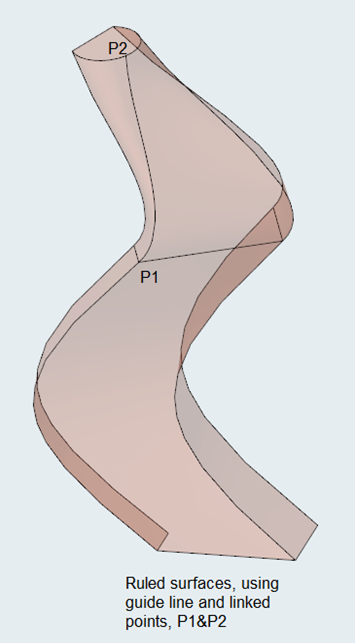

To create smooth ruled surfaces interpolating lines 56, 52, 53, 58, 57, 59 and 51 with the following conditions: ruled surface will be in the input lines component; split at the input lines; links point P1 = (2.3, 4.5, 6.0) and point P2 = (12.3, 2.25, 36.30), uses guide lines 44:
*createdoublearray 6 2.3 4.5 6.0 12.3 2.25 36.30
*createmark lines 2 44
*surfacecreateruled 1 1 6 2 0 3 1
