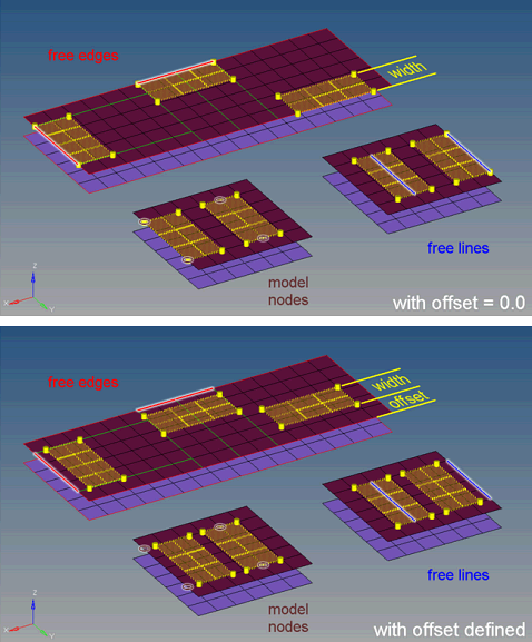

| width | Width of the connector area centered along the
line. Note: Only available when the location is set to lines
or nodelist.
| offset | Connector is offset from the free mesh edge along the link by
this distance. Note: Only available when the location is set to
lines or nodelist.

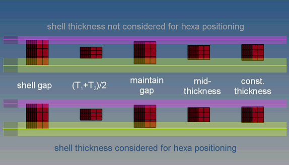

| thickness |
Select a method for defining the thickness of a hexa
weld.
Note: The exact hexa position is also influenced by
the option consider shell thickness and offset for hexa
positioning.

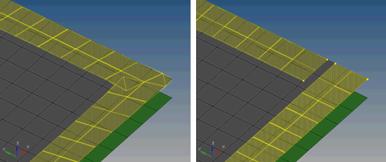

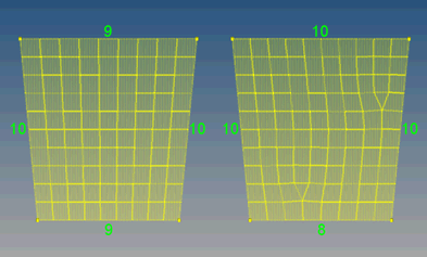

| link opposite edges | Force opposite edges of the area connector to use consistent
edge densities, provided that the starting densities are close
enough. This creates tapered lines of elements, instead of using
trias to transition between inconsistent densities.![]() Figure 4. Link Opposite Edges Example. Meshing with (left) and without (right) linked edges. |
