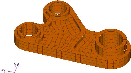

![]() Figure 2. Second Order Elements Created for Boundary Element Solutions |

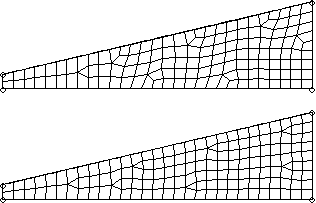

![]() Figure 12. No Flow Alignment ![]() Figure 13. Flow Alignment. Flow alignment is used, producing straighter rows of elements. |

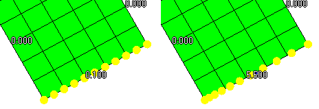

![]() Figure 16. Increase Biasing Factor |

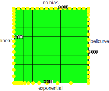

| bias style | Select the biasing style to apply to edges when using the set
edge and set all to options.![]() Figure 17. Example: Bias Style |
