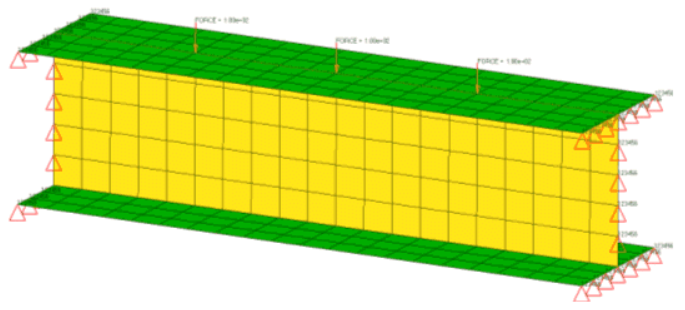

Figure 1. Original Model

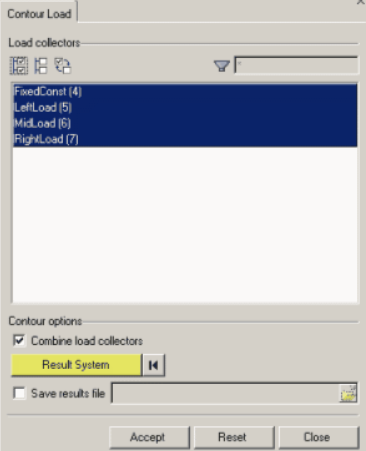

Figure 2. Contour Loads Utility

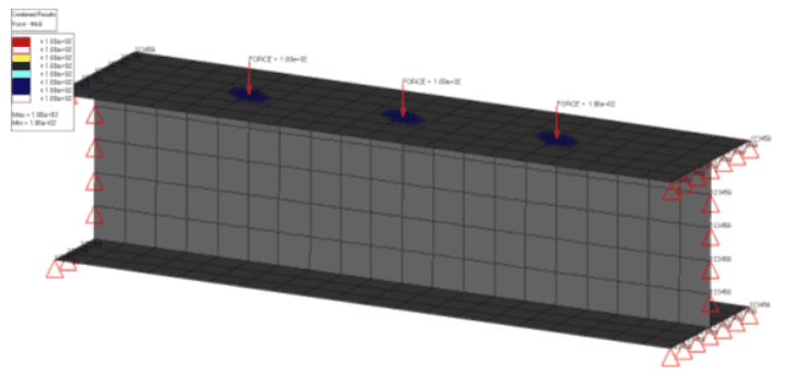

Figure 3. Contour Showing the Force - MAG Data Type

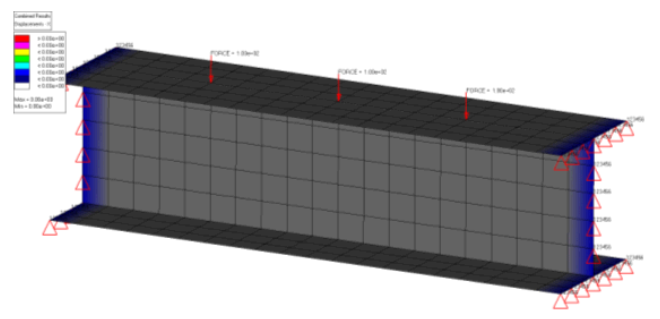

Figure 4. Contour Showing the Displacement - X Data Type
