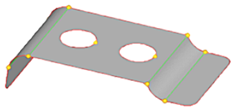

Figure 1. Pinholes on Top of Part

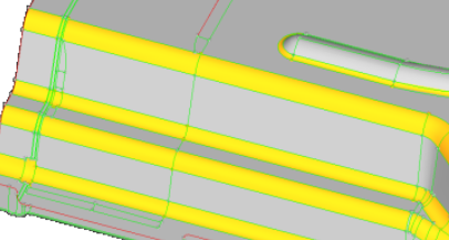

Figure 2. Surface Fillets. The curved yellow surfaces are fillets.

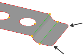

Figure 3. Edge Fillets. The arrows point to edge fillets.
