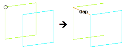

A gap element is an element created in a space between two nodes, or between a node and an element, of a model where contact may occur. Use a gap element when you want to impose a nonlinear constraint on a model; this constraint will limit the amount of movement possible during analysis. Gap elements have property pointers.
Gap elements are element config 70 and are displayed as a line between two nodes with GAP written at the centroid of the element.
