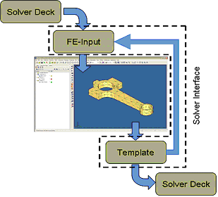

Solver Interfaces
Figure 1. Schematic of the Solver Interfacing Architecture
Templates

FE-Input Readers
FE-input readers perform the function of reading solver decks and importing solver cards into the appropriate entities with the appropriate card images, data names, and attributes set as defined by the template. Furthermore, FE-input readers require template attribute definitions to perform their tasks.
