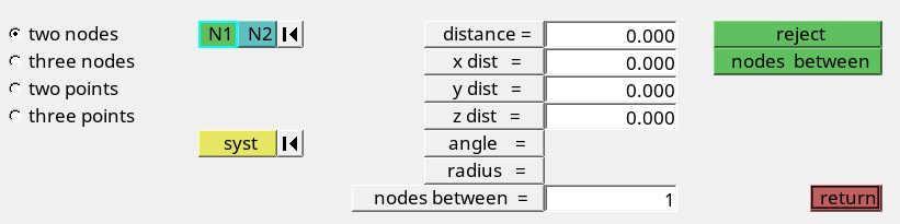

Figure 1. Distance Panel, Two Nodes Subpanel

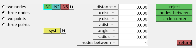

Figure 2. Distance Panel, Three Nodes Subpanel
To select a subpanel, click the radio button next to the subpanel name on the left side of the panel.

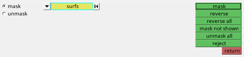

Figure 3. Mask Panel. The mask action is performed when you click the middle mouse button.
The rapid menu function is predetermined and varies between panels. In panels that contain multiple function buttons, rapid menu is assigned to the most commonly used function. The rapid menu function can also vary within a panel. For example, when you enter the Lines panel, return is assigned to the rapid menu. But once you pick a node to create the line, create becomes the rapid menu function. In most panels, the middle mouse button returns you out of the panel if the active entity selector (yellow collector with a blue outline) is empty.
In panels where there is a defined sequence of selections (entity selector), rapid menu advances to the next collector. For example in the Ruled panel, select a few nodes for your first node list or line list, and then click the middle mouse button to advance to the second node list so that you can begin picking more nodes. In panels where there is no clear sequence of selections, the middle mouse button may activate a function for which there is insufficient data, resulting in an error message. For example, when you try to move nodes using the N1, N2, N3 vector option in the Translate panel, if you click the middle mouse button after you select the required nodes, an attempt to perform translate + is executed. Since you do not have N1, N2 and N3 selected or may not have a magnitude value entered, an error message results.

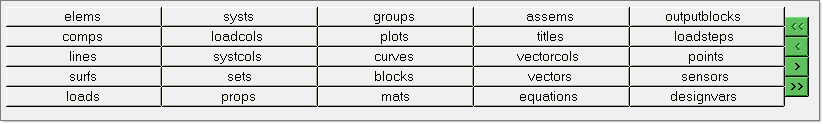

Pull-Down Selections
Figure 4. Pull-Down
Figure 5. Toggle
Figure 6.
- Go directly to the first page of the list.
- Step backward one page toward the beginning of the list.
- Advance one page toward the end of the list.
- Go directly to the last page of the list.
