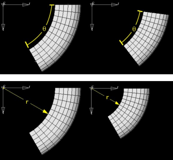

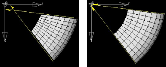

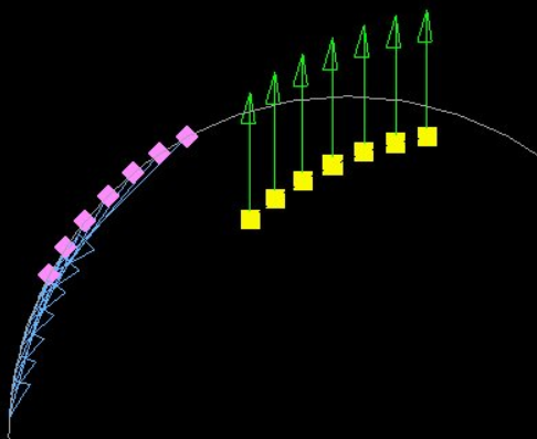

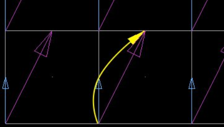

| by constraint / by system / by mid-shape | Shapes are saved as
linear perturbations in Engineering Solutions, therefore
additional information is required to determine the intended
non-linear path of each node when a shape is applied at values
other than zero and one. Some nodes move along constraints while
others travel about the z-axis of a cylindrical coordinate
system. Select the non-linear shape creation method according to
how you intend the nodes to move.
![]() Figure 4. Arc Angle Shape Change Applied Simultaneously with a Radius Shape Change. In the left figure the two shapes are applied with no compensation. Notice how the sides of the mesh no longer line up with the axis of the local coordinate system. In the right figure the compensation shape has been applied. Notice how the sides of the mesh now line up with the center axis of the local coordinate system. If both shapes are converted into non-linear design variables at the same time, the compensation design variable will be generated and integrated into the optimization automatically. When applied during optimization, the non-linear shapes will be close to, but probably not exactly aligned with, the intended node paths. Although the generated shapes and equations have been optimized to minimize the amount of error between the intended node paths and the actual node paths it is not possible to precisely mimic every non-linear shape using a combination of linear ones. However, this feature should allow sufficient fidelity for most optimization applications. Shapes to be converted into non-linear shapes perform best when they have either a lower bound or upper bound of 0.0, but good fidelity can be achieved for shapes which have a negative lower bound and positive upper bound. However, non-linear shapes which sweep out an arc of more than 90 degrees may not give good fidelity for intermediate values. |
