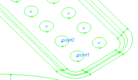

You can measure the distance between two nodes/points by specifying the two nodes/points; the total distance between the nodes/points, and the x, y, and z distances are displayed.
If you want to change the distance between two nodes/points, you can change the total distance, or any of the x, y, or z component values. The total distance will be recalculated if you have changed any of the x, y, or z component values. After you have changed the desired values, Engineering Solutions follows the initial vector and relocates the second node/point at the specified distance along that vector. The node selected as N1 will remain fixed, only the N2 node will be moved.

Distance between Two Nodes
Figure 1. Distance between Two Nodes

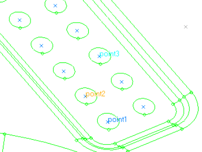

Distance between Three Points
Figure 2. Distance between Three Points

Angle between Three Points
Figure 4. Angle between Three Points

Two Points Subpanel
| Option | Action |
| point 1 / point 2 | Select the first and second points you wish to measure between. |
| syst | Specify the coordinate system within which to measure the distances and angles. The selected coordinate system affects the measured values only. If a non-rectangular coordinate system is selected, the meaning of the X,Y and Z component distances will change accordingly, although the field labels will not be changed. |
| distance | Specify the total distance covered by the selected set of nodes or points. |
| x, y, z dist | Specify the X, Y, and Z direction component distance between the selected nodes or points. |
| angle | Specify the angle formed by the three nodes or points, using node/point 2 as the angle vertex such that a straight vector equals 180 degrees. |
| points between | Specify the number of nodes/points you wish to create, which will be evenly spaced along the vector between the first and second selected nodes. |
Three Points Subpanel
| Option | Action |
| point 1 / point 2 / point 3 | Select the first, second and third points you wish to measure between. |
| radius | Specify the number of nodes/points you wish to create, which will be evenly spaced along the vector between the first and second selected nodes. |
