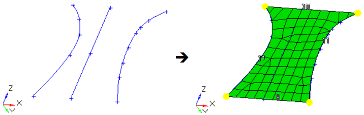

Use the Skin panel to create a skin surface and/or mesh from a set of lines.

| line list | Select the lines that you wish to create a skin surface between. The lines do not need to be contiguous, but should not be collinear. |

| create | A surface and/or mesh
is created that interpolates a set of lines in the order they
are selected. At least two lines must be selected. Select
auto reverse to insure the same
direction for all lines. The lines used to create the skin surface and/or mesh are automatically smoothed before it is created. As a result, the surface and/or mesh created has a single face. |
