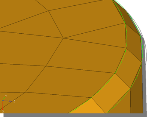

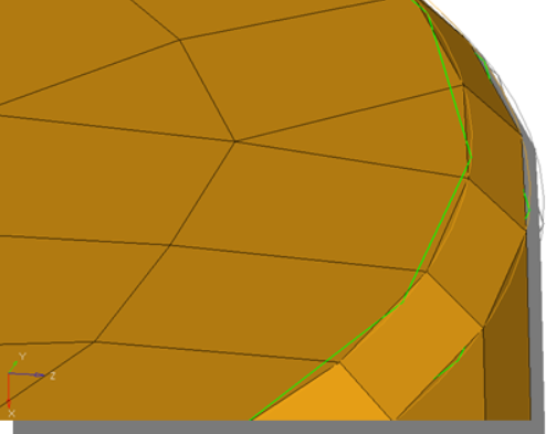

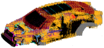

| geometry refinement | Select a geometry
refinement level to control how extensively the graphics engine
smooths faceted feature lines and contours within geometric
entities such as lines and surfaces. The degree of faceting is arbitrarily numbered from 1 to 5, with 5 being the most refined and 1 being the coarsest. Higher values may affect rendering performance. If you do not want to
continuously keep adjusting the degree of faceting, select
Auto to automatically increase
the geometry resolution when you zoom in on a model.
Note: You can set Auto as the default level of
refinement by entering the environment variable
HM_AUTO_REFINEMENT=1.
![]() Figure 2. Lower Refinement ![]() Figure 3. Higher Refinement |
