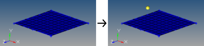

Add Links Panel
Use the Add Links panel to add link entities to existing connectors.
Location: Connectors module
