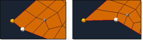

| true rotation | Clear this checkbox to
rotate the handles, with the mesh morphed linearly according to
their new locations (left image, following). When selected, true
rotation rotates both the nodes and the handles, with the amount
of rotation for the nodes being proportional to the amount of
influence of the handles over those nodes. (right image,
following).![]() Figure 6. |

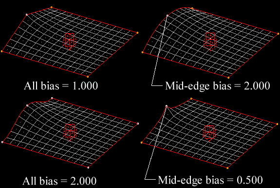

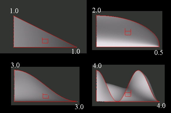

Use the Set Biasing subpanel to change the biasing factors associated with each handle. You must click update to apply bias changes to the handles, unless you update them interactively.
Clicking screen edit will display edit windows for the bias factors if they are not displayed or hide the edit windows for the bias factors if they are displayed.
The initial bias factor for all handles is 1 except for dependent handles automatically generated at the ends of 1D domains which are given a bias factor of 3. Higher bias values will increase the influence that handle has over nearby nodes. Lower bias values decrease the influence. Bias values of 1 give linear results that result in morphs with sharp angles at the handle locations.
For exponential biasing a bias value of 2 will result in morphs with a gentle curvature through the handle locations. Using bias factors of 1 at the corners of a model and 2 everywhere else will generally give a smoothly morphed model.
For sinusoidal biasing a bias value of 2.0 for a handle at one end of an edge domain and 0.5 for a handle at the other end will give a perfect circular or elliptical curve for the domain. For values of 3.0 and higher the influences will obey a sine-cosine curve with a frequency equal to one-half cycle plus one for each full step above 3.0 (that is 4.0 gives a frequency of one and one half cycles, 5.0 gives two and a half, and so on). Values between 2.0 and 3.0, or 3.0 and 4.0, or 4.0 and 5.0, and so on, blend the influences of a full sine-cosine curve at the higher value with that of a linear curve. In other words, a bias factor of 4.7 will give influences that are 70% of what they would be for a biasing factor of 5.0 and 30% of what they would be if they were linear.
