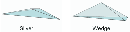

One function is to remove sliver elements – tetrahedral elements which are so flattened that all of their nodes are very close to planar. If the element's Aspect Ratio (the ratio of its maximum length to its minimum length) is high, the element is a sliver; otherwise, it is a wedge.
Figure 1. . This sliver is nearly flat in the horizontal plane, while this wedge is nearly flat in the vertical plane.
