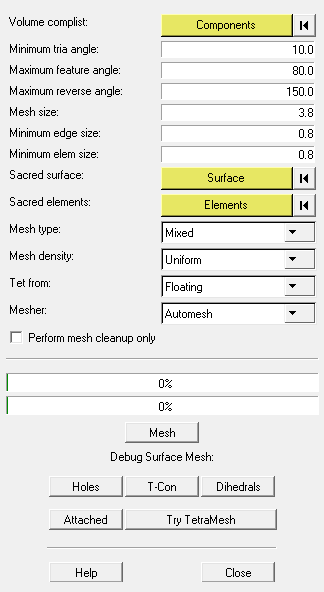

Figure 1. -
Use the options in the macro to define the tetramesh.
Option Description Volume complist Double-click components and use the comps collector that displays in the panel area to select comps representing the geometry of the solid to be tetra meshed. Surfaces and/or elements can be used to define the volume. Click proceed to finalize the selection. Minimum tria angle The surface trias from which the tetramesh will be extrapolated will be generated with angles that measure at least this many degrees. Use this control to limit how acute the resulting elements will be. Maximum feature angle The maximum feature angle protects nodes on corners with a feature angle greater than the value specified, helping to better maintain the geometry. This applies only to cases where you can maintain features while fixing minimum element size. For example, if two nodes of an element share different features (as in thin steps), the features may not be maintained as they do not pass minimum element criteria. Maximum reverse angle The maximum feature angle allowed between normals of adjacent elements. If the feature angle exceeds the given value, two adjacent elements are considered reversed and actions are performed to correct the situation. Mesh size Average element size of the mesh to be created. Minimum edge size No single edge of any generated element will be shorter than this. Minimum elem size Minimum allowable area for any element. Sacred surface When element nodes are moved to improved element quality, it gives special preference to trying to keep the nodes on a sacred surface. Note: This does not work if two adjacent surfaces are both marked as sacred.Mesh type The mesh type options are Trias Only and Mixed. With the Mixed mesh type, both trias and quads may be created. Mesh density Choose between chordal deviation and uniform. - Chordal deviation

Mesher Choose between automesh and batch. This determines the meshing engine used: the one used by the Automesh panel, or the one used by the BatchMesher. The BatchMesher generally produces better results, but does not currently support sacred surfaces or elements, ignores/replaces existing elements, and always uses uniform density. Perform mesh cleanup only When this option is checked, no tetra elements are created and the macro simply goes through the cleanup steps for the shell mesh. Some of the cleanup operations performed are: the suppression of free edges, correction of sliver elements, splitting of elements, and projections onto the original geometry. All the cleanup steps are designed to improve the mesh quality. Debug Surface Mesh A series of tools that help you locate problem areas which can cause poor meshing. - Find Holes
