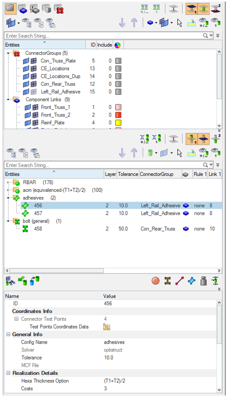

Use the Connector Browser to view and modify connectors in the current model.
From the menu bar, click .
- The Link Entity Browser, located in the first pane of the tab, displays information about all of the linked entities in the model and Connectors groups.
- The Connector Entity Browser, located in the middle pane of the tab, displays a tree view of all the connections the model contains. Engineering Solutions organizes and displays the connectors in different folders based on their respective realization type. The names of the folders are obtained from the FE configuration names that are specified for respective solvers in the feconfig.cfg file.
- The Connector Entity Editor, located in the last pane of the tab, displays attributes assigned to the connector(s) selected in the Connector Entity Browser.
