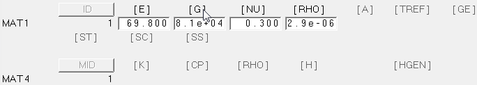

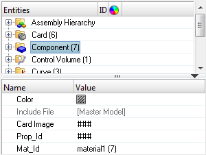

Edit Multiple Entities
If you select multiple entities in the browser, the Entity Editor opens and displays the selected entities common corresponding data that can be modified simultaneously.
The rows that contain ### indicate that these fields do not contain common data but can still be modified. When you modify the data, both common and ambiguous, Engineering Solutions applies the changes to all of the selected entities.

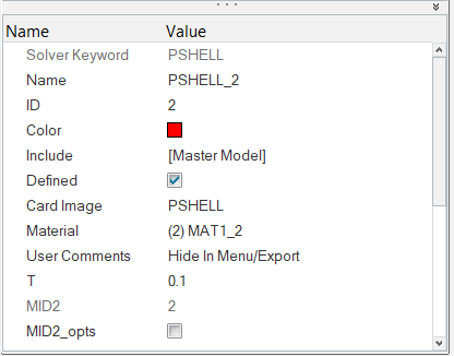

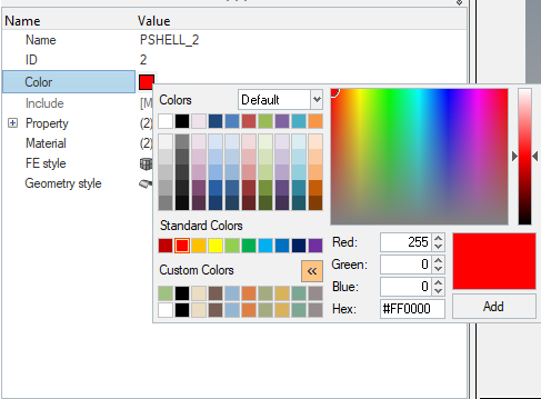

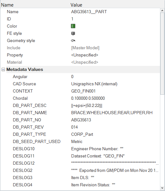

Edit Engineering Solutions Specific Data
When you create an entity, it is assigned an unique ID, name and color. Use the Entity Editor to edit this data.
| Option | Description |
| Edit ID and name |
![]() Figure 4. |
| Edit color |
![]() Figure 5. |

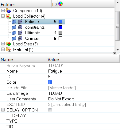

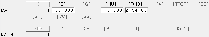

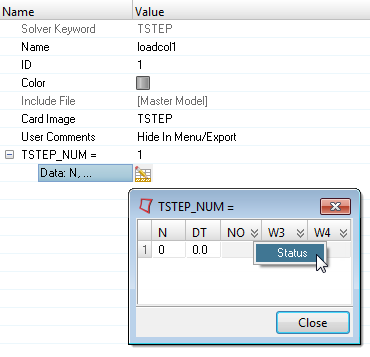

Edit Solver Specific Data (Template Data)
Every entity is assigned solver specific data, which you can modify using the Entity Editor.
Figure 6.

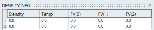

- Import and export functions are not available for 2D arrays or a combination
of 1D and 2D arrays, as in the case of Abaqus.
Figure 8. Density Info for ABAQUS_MATERIAL - Certain control cards make use of unstructured tables. In these cases, array
attributes are shown as new categories/columns and data cannot be
imported/exported.

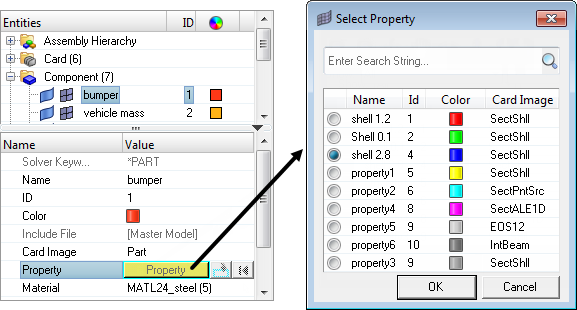

Assign Entities

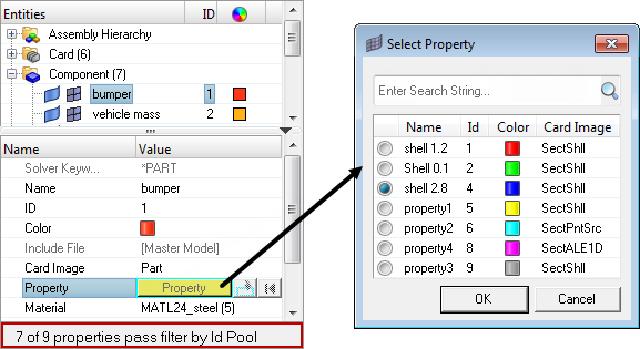

In the Entity Editor you can assign certain entities to another entity or a group of entities.
For example, you can assign a property to a component. When an entity has an entity assigned to it, the name and ID of the assigned entity will be displayed in the Value field. If an entity does not have an entity assigned to it, the Value field will display <Unspecified>.
Figure 19.

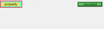

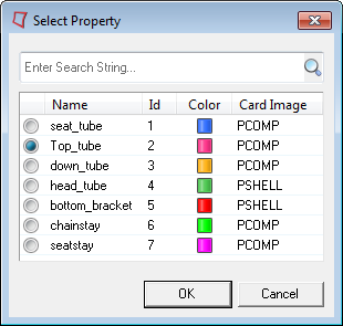

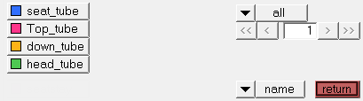

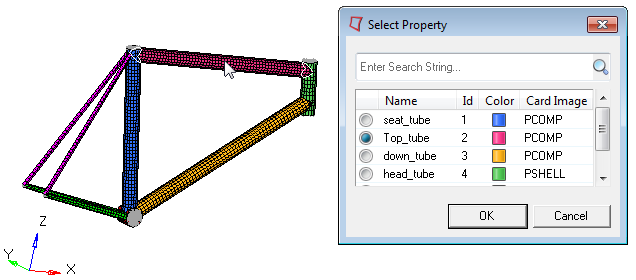

In the Entity Editor, you can assign an entity using the Select dialog or the Entity Selector.
Method 1: Assign Entities Using the Select Dialog
Method 2: Assign Entities Using the Entity Selector

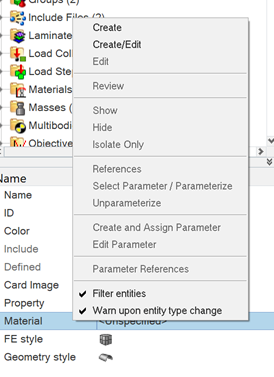

Create and Edit Assigned Entities
Create, edit, and assign new entities to an existing entity or group of entities in the Entity Editor.
Create and Assign a New Entity
To create and assign a new entity to an existing entity or a group of entities:
- Create - Define a new entity using an embedded Entity Editor.
- Create/Edit - Define a new entity using a standalone Entity Editor.
Figure 27.
Edit an Assigned Entity
To edit an entity that is assigned to an existing entity or a group of entities, do one of the following:
Click
next to an entity assignment field. In the embedded
Entity Editor, modify the entity data. When you are
finished making changes, click
to collapse the editor.
- Right-click on an entity assignment field then select Edit from the context menu. Modify the entity data using the standalone Entity Editor. When you are finished making changes, click Close.

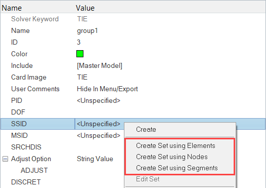

Create and Assign Sets to Main or Secondary Entities

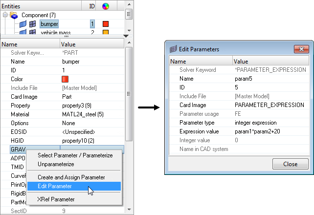

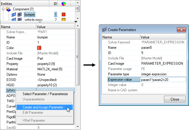

Create and Edit Parameters
In the LS-DYNA, OptiStruct, and Radioss user profiles, certain entities can be defined with parameters in the Entity Editor.
Create and Assign a New Parameter
Edit a Parameter

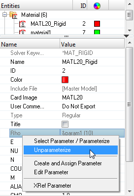

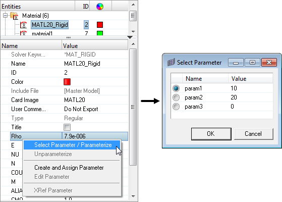

Parameterize and Unparameterize Entities
For any solver entity, you can parameterize most of the solver template data of a numeric value in the Entity Editor.
Parameterize an Entity
Unparameterize an Entity
Figure 32. Parameter Rho is being Unparameterized with the Parameter param1.

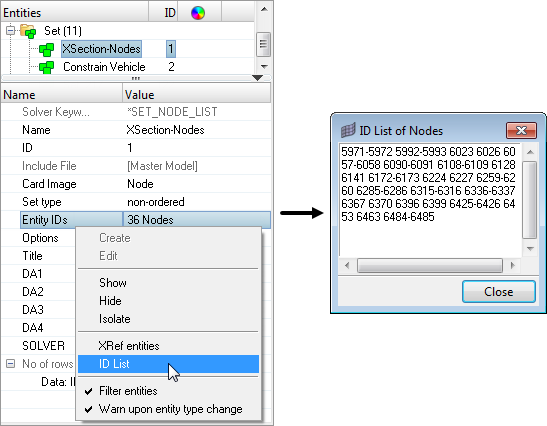

View an ID List for Set Entities
Set entities are used to define and store lists of entity IDs for a specific entity.
Sets can be generated for nodes, elements, components, assemblies, properties, materials, ellipsoids, multibody planes, multibody joints, and multibodies which contain entity IDs for that specific entity. In the Entity Editor, you can view an ID list for set entities. The entity IDs are compacted using ranges, and segregated using ID pools. If some of the IDs are unresolved, than they will be listed separately under Unresolved IDs.

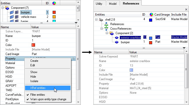

View Xref Entities
Figure 36.
or press
