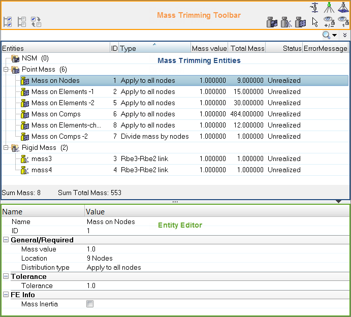

Mass Trimming Tool Interface
The Mass Trimming tool opens in the browser area.
The toolbar at the top of the Mass Trimming tool consists of tools used to create mass entities and control their display state.

Define mass entities in the Entity Editor.
You can modify the distribution type, mass value, and total mass in the Mass Trimming Browser.
- In the Mass Trimming Browser, select the mass to define.
- In the Entity Editor, define the mass.

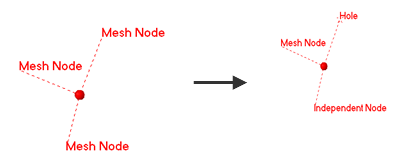

- Attachment point
- To define the attachment points, nodes have to be selected in the
model. Node selection is not used as is. A search is performed to see
what is attached to the nodes.
- If a node is selected on a hole, then the center of the hole will become the attachment location. If multiple nodes on a hole are selected, they will still treated as one attachment.
- If a node is selected on a mesh, then the nodes of the attached elements (shell or solid) will be selected.
- If two or more nodes are selected in close proximity and the attached elements are adjacent, then the entire patch will be selected.
- If an independent node of a rigid is selected, then the independent node is selected for the attachment. The second leg is not created for two level rigid masses, such as RBE3-RBE2 or RBE3-RBE2 links. The first leg is terminated at the independent node.
- If the free end of a CBUSH, with or without a tag, is attached to a rigid on the other end, then the second leg is not created and the rigid type mass is terminated at the first leg.

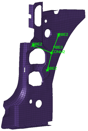

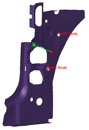

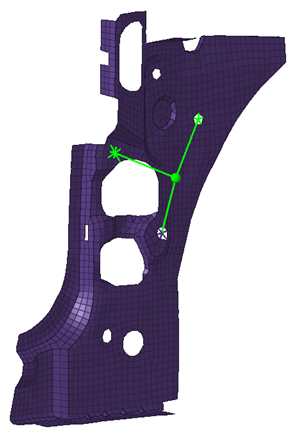

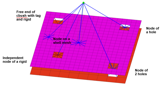

Figure 2. Nodes Selected for Attachment Points
Figure 3. Manual Mode for Single Level Rigid Creation. In this mode, only the selected nodes are used to define the rigid.
Figure 4. Automatic Mode for Single Level Rigid Creation. If the Manual option is not enabled in the Entity Editor, the nodes of adjacent elements will be used to define the rigid if the selected nodes are on a hole or are nodes on a mesh.

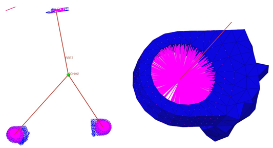

Figure 5. Two Level Rigid. In the case of a two level rigid, Automatic and Manual mode is not available. Instead, input nodes are processed. If input nodes are on a hole, then the nodes of the hole are used. If the realization is set to inside or inside/outside, then washer nodes are used. When the input node is an independent node or the free end of a cbush attached to a rigid, then the second level rigid will not be created. The RBE3 from the conm is terminated at these nodes.

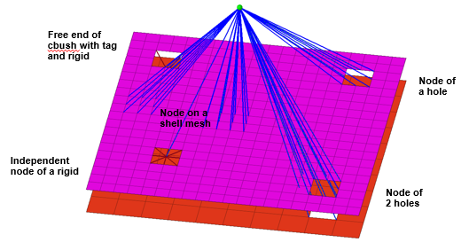

- In the original mesh, the attachment type is a node on a shell mesh which
finds nodes of adjacent elements to create the second level rigid.

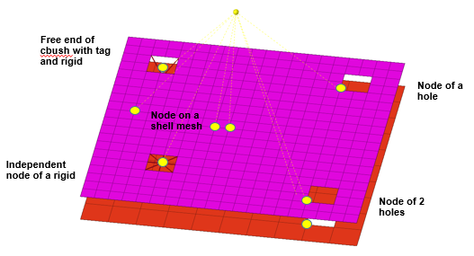

Figure 7. - When the mesh is deleted and realized, the realization fails. The modeling window indicates what it is looking for at those
attachment locations.
Figure 8. - When importing a new mesh, there is no shell mesh near the attachment within
the tolerance at two locations; however, there is a hole and an independent
node. After realizing, the mass fails at the two locations.

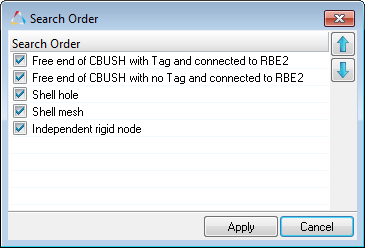

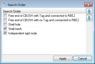

Figure 9. - Executing a search order with the following settings finds alternate
attachment methods. The search order is set to first look for independent
node. If no independent nodes are found it will then look for a shell mesh.
The other options are not selected.

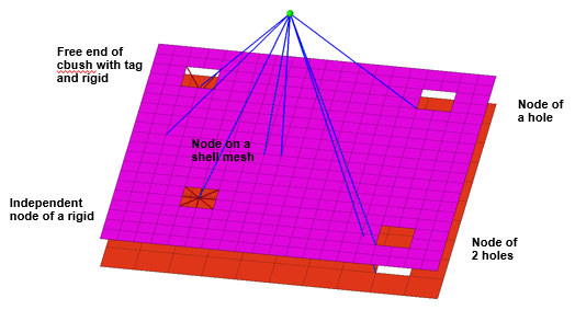

Figure 10. - The image below shows the alternate attachments that were found at those
locations, which are realized.
Figure 11. - If the mesh is deleted and realized again, the new attachment method will be
used for sub-sequent realizations. The original attachment method was node
on a mesh at all three locations, but after executing the search order on
the new mesh, the attachment methods change.
