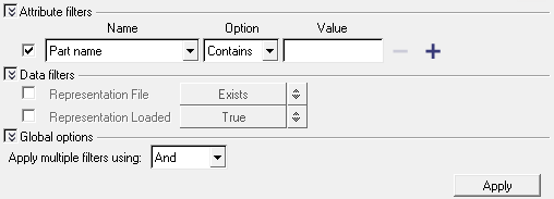

To filter BOMs, apply the following advanced filters:
Apply Attribute Filters
Use these filters to determine, which Attribute(s) to filter upon.
Apply Data Filters
Use these filters to determine what data appears in the Assembly Browser.
- To activate the Representation File filter, select its checkbox.
Click the Representation File toggle and select:
- Exists
- Does Not Exist
- To activate the Representation Loaded filter, select its checkbox.
Click the Representation Loaded toggle and select:
- True
- False
Apply Global Filters
- And:
- Or:

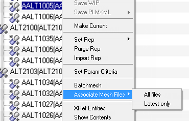

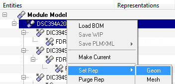

Assembly Browser Context Menu
Access advanced Assembly Browser options from the context menu when you right-click on a module in the browser.
Load BOM

Set Rep

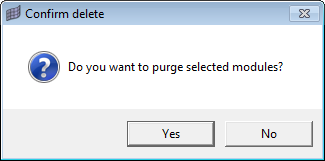

Purge Rep
Figure 4.
Engineering Solutions will still maintain the representation in the hierarchy, and you can import when desired. When you purge a module, all of the changes you have made to the contents of the module will be lost permanently. Engineering Solutions will not automatically update the files in the current representation with the updated content. To retain the changes, you must save the modules as a HM file (or Solver file) before purging.

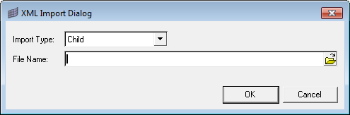

Import Rep

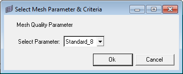

Set Param-Criteria

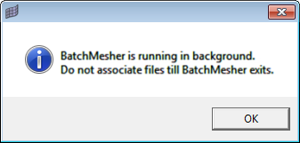

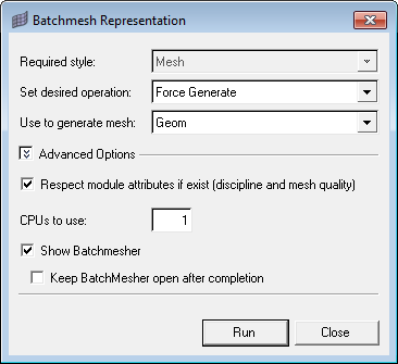

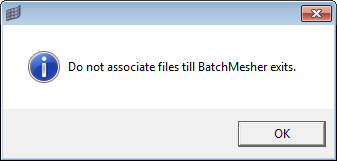

Batchmesh
Associate Mesh Files
Figure 9.
The associate mesh file also searches the mesh files based on their extension and CAD file name. If Engineering Solutions associates the wrong mesh file, select and then locate the appropriate file.

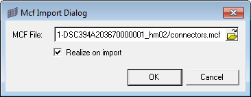

Realize Connectors
