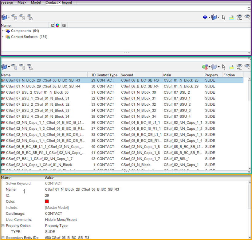

The Contact Browser lists every contact interface and surface within a Engineering Solutions session and organizes them into their respective folders. You can modify these contact interfaces and surfaces using the Entity Editor.

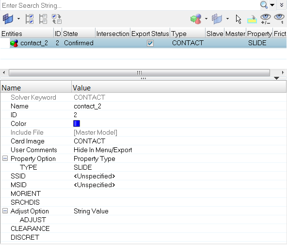

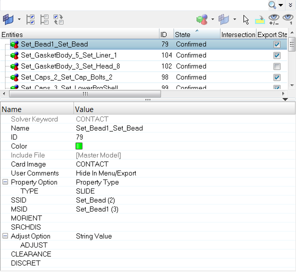

- AutoContact can create contact pair/tie with review status before confirming.
- In the contact information pane (middle pane in the browser), you can interactively add friction, adjust, and specify other optional parameters.

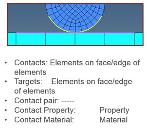

- ANSYS contact regions are modeled like ordinary FE elements over the regions of FE models that represent the geometry. In ANSYS terms, both CONTACT and TARGET surfaces are sets of elements at contact regions. Prior to Engineering Solutions 14.0.130, the ANSYS interface supported the same principle as ANSYS, therefore both CONTACT and TARGET regions were elements over model geometry in Engineering Solutions.

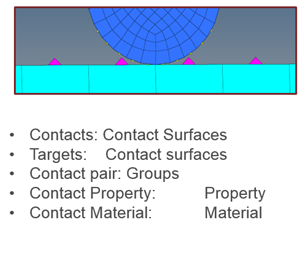

- Starting in Engineering Solutions 14.0.130, both contact and target regions are identified as CONTACT SURFACES. A pair of contact and target surfaces which interact with each other in analysis are GROUPS. You need to create contact surfaces for both CONTACT and TARGET regions. They will then be paired together under groups to successfully define the contacts. ANSYS solver files (*.cdb files) with contacts are imported into Engineering Solutions, and identify the contact regions from the contact elements to show the regions as contact surfaces. Contact pairs can be seen in groups.
- During export, Engineering Solutions creates contact elements from the contact regions and exports them as elements. In ANSYS, they are explained above elements with contact element type.

- The Contact type Touch creates a contact pair, and the Contact type Gap/Tie creates a Tie contact.
- Master ID and Slave ID types will be as per solver default Set of elements for master ID and Set of nodes for slave ID.
- Auto contact will honor the entity type in Master and Slave entity type.
- Master entity types have the following mutually exclusive options: Set of elements or SURF. Similarly Slave entity type will have Set of nodes, Set of elements, and SURF. You can only select one of the entities.
- The Contact property option is only available when the Contact type is Touch.
- You can assign Touch contacts a Property type (SLIDE, STICK, FREEZE), a Static Friction Coefficient, or an existing property (PCONT).
