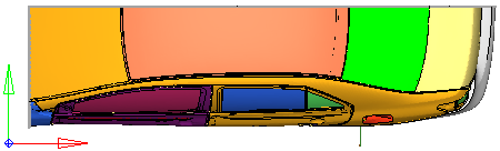

Use the Box Trim utility to trim the model, or selected subset, along the global axis to fit the selected 3D box.
For example, a full car model can be trimmed along the Y=0 axis to obtain the left or right side of the car. A fixed boundary condition is applied at the trimmed edges. It also removes the FE entities outside of the box, and cleans the model so that it is a runnable deck. The axis directions and terminology are based on modeling standards in the automotive industry.

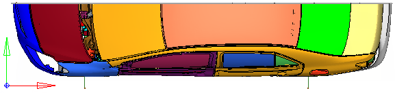

Table 1. Option Description Box trim type Determine how the selected model will be trimmed by selecting one of the following options from the pull-down menu: - left
- Split the model along global Y=ymiddle and save
the model between Y=ymin and Y= ymiddle (ymiddle
=(ymin+ymax)/2).
Figure 1. - right

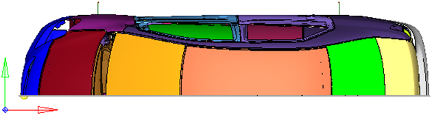

the model between Y= ymiddle and Y=ymax.
Figure 2. - front

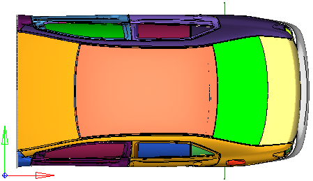

- Split the model along global X=value (selected
value) and save the model between X=xmin and
X=value.
Figure 3. - rear

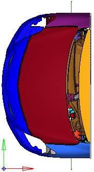

value) and save the model between X=value and
X=xmax.

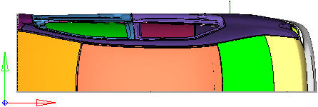

Figure 4. - frontleft
X=value (selected value) and save the model
between Y=ymin and Y=ymiddle, and X=xmin and
X=value.

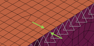

Remesh options Enables access to additional options that help clean the trimmed edge elements in order to achieve a better mesh quality. Min size Defines the minimum size of remeshed elements on the trimmed edge. Element size can be defined by selecting one of the following options from the pull-down menu and entering a corresponding value in the elem size field. - relative
- Multiplier of the local element size
- absolute
- Actual element size
Figure 9. . Min size > 3 (absolute)
Figure 10. . Min size > 5 (absolute)Delete comps with Enables a filter to delete components after the trim. The components that are deleted after the trim can be defined by selecting one of the following options from the pull-down menu and entering a corresponding value. - num elems
