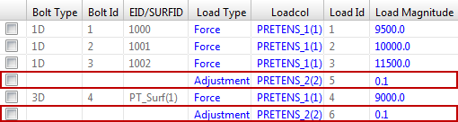

| Button | Description |
| Add 1D Bolts | Allows you to create one or more 1D Bolt Pretension
sections. To add a 1D Bolt Pretension section:
| Add 3D Bolts | Allows you to create one or more 3D Bolt Pretension Sections.
Two options are available when you click Add 3D
Bolts:
When you are using the Create New Surface option, a default name will be automatically assigned in the panel using the prefix PRETENS_* and the appropriate card image. Once you click Create and Return, you will be brought back to the Pretension Manager. The Pretension Manager will now display a 3D Bolt Pretension section for the new contact surface. |
| Add Load | Allows you to add a new pretension load to an existing Bolt
Pretension section. To add a new pretension load to an
existing
| Delete | Deletes the selected bolt pretension sections and/or
pretension loads. To delete selected bolt pretensions
section:
When a Bolt Pretension section has more than one load applied to it, deleting the bolt section at the top level will automatically delete all the loads applied to it. On the other hand, deleting single additional loads will only remove the selected loads. |
| Review | Allows you to graphically review the Element/Surface, Load,
and SPOINT assigned to the selected Bolt Pretension section.
This button also displays more detailed information about the
selected Bolt Pretension section's Orientation. To review a
Bolt Pretension selection:
| Select All | Select all rows in the table. |
| Select None | Deselect all rows in the table. |
| Select Reverse | Reverses row selection in the table. |

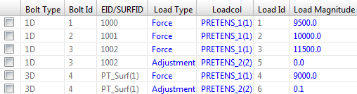

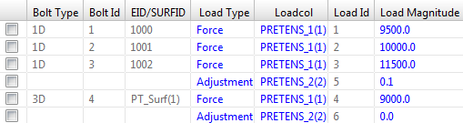

| View | Controls the Pretension Manager table's
view organization mode. There are two options available from the
pull-down menu:
