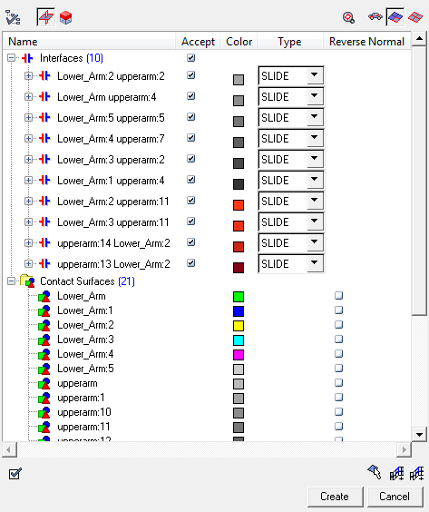

Auto Contact Browser
The Auto Contact Browser provides options for reviewing and modifying contact interfaces and surfaces found by the Auto Contact tool.
Auto Contact Browser Columns
| Column | Description |
| Name | Lists the names of all of the contact interfaces and surfaces
found by the Auto Contact tool. Underneath each contact interface name is the temporary master and slave surfaces associated to that interface. Red indicates a slave surface, and blue indicates a master surface. Renaming entities, as well as Master/Slave surface swapping is possible via the context menu. |
| Accept | This checkbox defines whether or not a contact interface will be included in the creation process once you click Create. |
| Color | Color that will be assigned to the contacts and contact surface entities. |
| Type | Type of CONTACT assigned to each contact interface. |
| Reverse Normal | This checkbox defines whether or not the normal direction of the given surface should be reversed or not. When OFF (default), surfaces on 3D elements will be pointing outwards, and surfaces on 2D elements will point in the direction of the element normal. |
