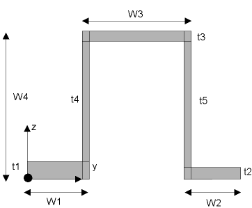

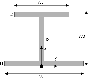

The following images indicate the location of the value fields in the SECDATA card, such as W1, W2, t1 and t2.
Figure 1. I Beam

Figure 9. HATS Beam
