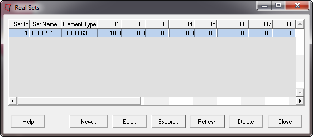

The Real Sets macro creates property card images for all elements that the ANSYS interface supports.
With this macro, you can view the real constant values of existing real sets, create new real sets, and edit the properties and reference numbers of existing real sets.
The Real Sets macro dialog displays the real set, reference numbers, element type of the property set, and the real constant values for that element type.
Rows can be sorted by set name, set ID and the element type column.
| Button | Action |
| Help | Provides information about the macro. |
| New... | Opens the Create Real Sets dialog, from which you can specify parameters for a new real set and create it. |
| Edit... | Opens the Edit Real dialog, from which you can review and change parameters for an existing real set that is selected in the table. |
| Export... | Allows you to export the table in .csv format |
| Refresh | Refreshes the Engineering Solutions database with changes you made through the Real Sets macro. |
| Delete | Deletes the real set(s) that is selected in the table. |
| Close | Closes the Real Sets macro dialog. |
