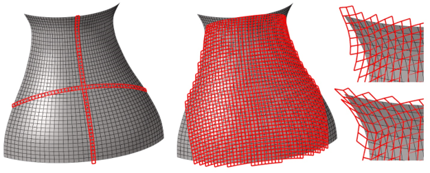

Draping of the elements that have two known node points (left). Draping propagation
is on initially orthogonal directions. Draping of the elements that have three known
node points (middle). The coverage is based on the primary draping paths. Restart of
the draping (right) and full coverage. For the restart the default Relaxation angle
has been first used. Then, maximum Relaxation angle has been used. The associated
model Revolution.hm can be found in tutorials\hm
folder of your installation.
