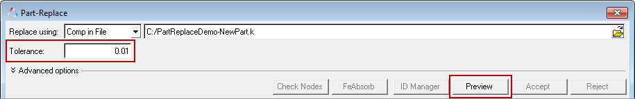

In the Tolerance field, enter a tolerance to search for
closest nodes and elements to re-establish the connections and other references
between the target part and the model.
The default tolerance is set at 0.01.

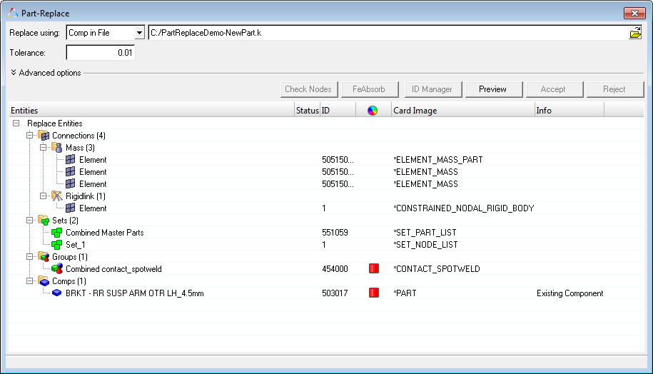

Click Preview to show the status of the reconnection of
the target part to the model.
Tip: If you change the tolerance, you can click Preview to re-examine the effect of the change before accepting it.

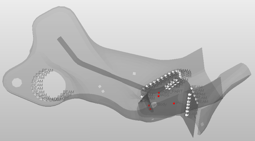

To display connections, click Check Nodes.
Connections are displayed in the Status column and in the graphics area.

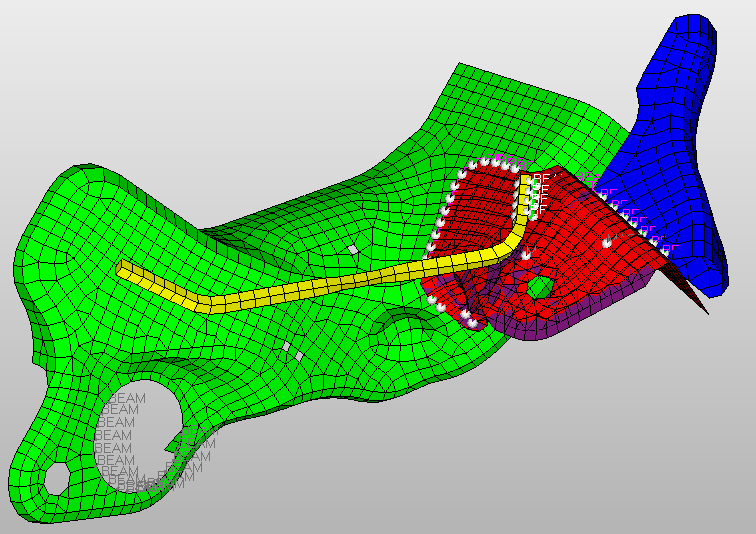

Figure 3.In the graphics area, green connections are highlighted white and red connections are highlighted red.

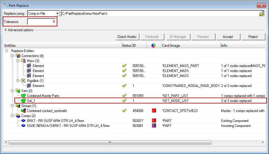

Adjust the tolerance for the target part as needed, then click
Preview to see the status.
In the example below, the tolerance is changed to 5 and all of the connections are re-established.
Figure 5.
Figure 6. -
After adjusting the tolerance, click Accept.
The source part is deleted and the connection of the new part to the model is accepted.Note: If the source part is connected by meshless welds, clicking Reject does not restore the model and welds to their original state prior to the part-replace operation.

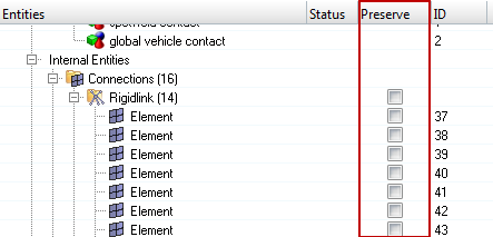

To preserve internal entities so that they will not be deleted after part
replacement, in the Preserve column, enable the checkbox.

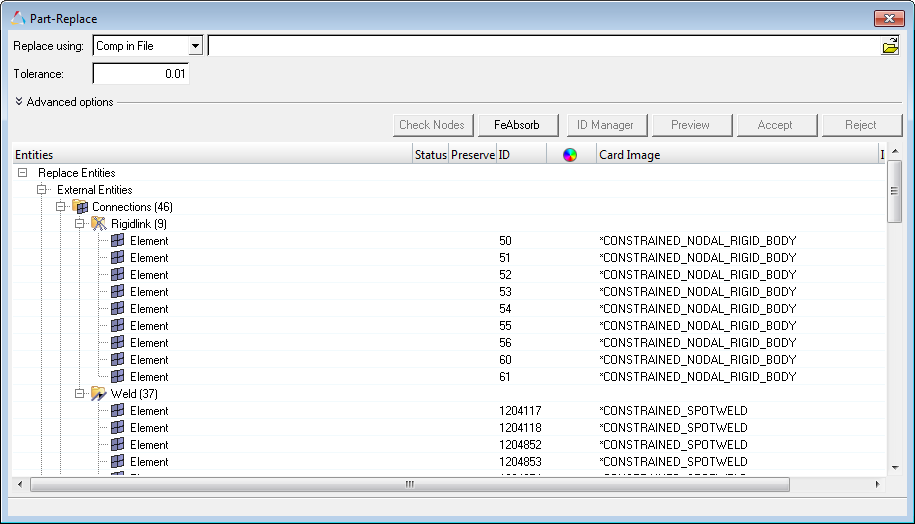

Figure 8. - Optional: External and internal preserved connections are preserved automatically during part replacement. To move the absorbed connectors to the current Include file, click FeAbsorb.

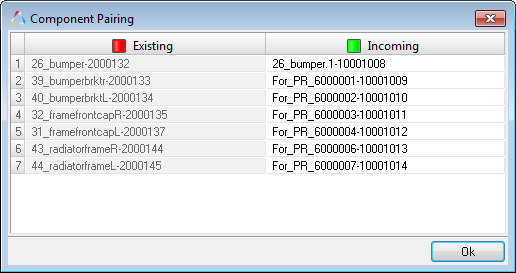

If you are manually replacing components in the Component
Pairing dialog, modify the component pairing and click
OK.
- In the Incoming field, select whether to remove the pairing, add a new pairing, select a new pairing, or select to not replace the references.
- Review, show (show all), isolate, or reset the components in the pair using the options in the right-click context menu.

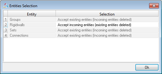

In the Entities Selection dialog, specify replacement
methods for incoming/existing entities and click OK.
- Choose Accept incoming entities (existing entities deleted) to delete all of the internal entities on accept.
- Choose Accept existing entities (Incoming entities deleted) to delete all of the incoming entities on accept.
- Choose Merge existing and incoming entities (no entities deleted) to retain both existing and incoming entities on accept.

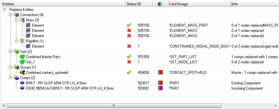

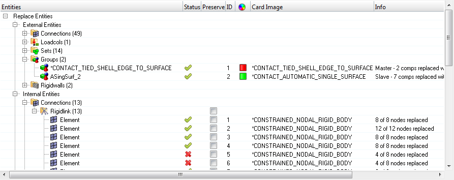

Check the status of each entity.
Note: All internal entities are deleted, and all external entities are updated.
Figure 11. -
Connections are displayed in the Status column and in the graphics area. In the graphics area, green connections are highlighted white and red connections are highlighted red.
