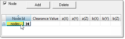

In the first data line, double-click the Node Id
field.
Figure 2. - Using the node collector, select a node.
- To apply your selection and go back to the Contact Manager, click proceed.

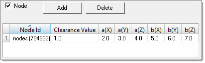

Specify the following:
- Clearance Value
- a(X)
- a(Y)
- a(Z)
- b(X)
- b(Y)
- b(Z)

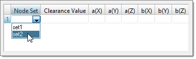

In the first data line, click the Node Set field and
then select a node set from the list.
Figure 4. -
- Clearance Value
- a(X)
- a(Y)
- a(Z)
- b(X)
- b(Y)
- b(Z)

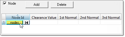

field.
Figure 5. - Using the node collector, select a node.
