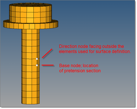

When the pre-tension definition is modeled by truss or beam elements, use the Select button to pick the 1D element to which the pre-tension shall be applied. When the Auto generate pre-tension node option is on, a pretension node in the middle of the selected element will be created. The same node will be populated in the By Node ID field and will also receive an Engineering Solutions tag Pretension_Node_<node id>.
If Auto generate pre-tension node is not active while selecting the 1D element, you can select a pre-existing node or node set, or as an option, create a node set and select this node set to apply pre-tension load and boundary conditions on.
The tool then creates a surface (*SURFACE) cutting through the bolt at the location of the base node. It also creates a node in the surface plane, outside the bolt and not attached to the model. This node automatically gets an HM tag HMpre-tension_node so that it is easier to find.
If you want to use existing surfaces, pre-tension nodes or node sets, you need to disable the automatic surface and node generation setting and assemble each part of the pre-tension section manually.
