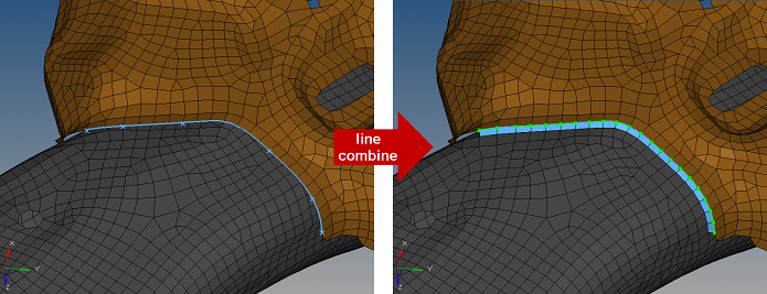

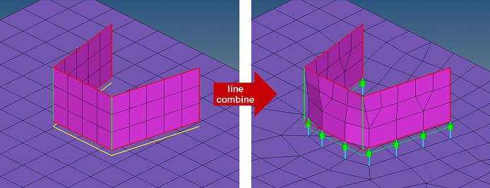

| line combine |
Create one seam connector for each sequence of lines and each single line. With this option enabled, a sequence of lines will be internally treated as on line. This option is preferred for continuous seams together with realization types where the body element is positioned between the weld points of all quad and hexa seam realizations. With this option, neither the vertices nor the start point
and end point of the initial lines are considered, and there likely will not be any
weld points at the exact positions.
Note: Default setting when location is set to
linelist.
![]() Figure 1. ![]() Figure 2. |

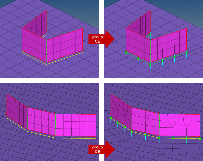

| group CE |
Create one seam connector from each selected line, and group those
seams which form a sequence of seam connectors together. Each group of connectors is
then treated as a single connector entity. Each connector in the group has the same
display mode, same realization state, and so on. Furthermore the start points and
end points of two sequenced connectors in that group are treated as being one point.
This fact allows this option also to be used together with realization types where
the body element is positioned between the weld points, such as for all quad and
hexa seam realizations. For hexa seams and for use of quad transition, the vertex
angle has to be quite small to prevent bad hexa elements or imprint
conflicts.
Note: The selected lines need to be longer than half the spacing
length, otherwise the lines are ignored.
![]() Figure 3. |

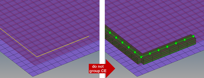

| do not group CE |
Create one seam connector from each selected line. Even those
seams which form a sequence of seam connectors are not grouped together. The start-
and end- points of two sequenced connectors in that group are treated as being
different points. This fact makes the use of quad transition impossible for
sequenced seam connectors, because the imprint patterns will always conflict each
other.
Note: The selected lines need to be longer than half the spacing length,
![]() Figure 4. |

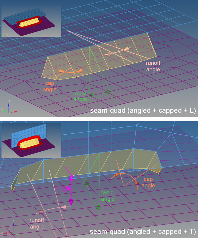

Quad Realization Options
Figure 5.
| Option | Action |
| weld angle | Define the distance between the normal projection and the
quad direction. Principally it is allowed to define weld angles between 0.0 and 90.0. If the value is set to 0.0 an internal thickness-based calculation is used. If the value is set to 0.0 and no thickness is defined the connector will fail. If the angle is created in the wrong direction, the seam can be reverted by enabling the reverse direction checkbox and performing a rerealization. |
| cap angle | Depending on the seam-quad type, the cap angle is measured
differently.
Cap angles are created by default. Clear this checkbox to remove cap angles and runoff angles. Cap angles
between 0.0 and 45.0 are permitted, but be aware that larger
values can lead to bad elements. The recommended value is
10.0 or smaller. Cap angles between 45.0 and 90.0 are
permitted, but be aware that smaller values lead to bad
elements. The recommended value is 75.0 and
higher.
Note: Only available for seam-quad (angled +
capped + L) and seam-quad (angled + capped +
T).
| runoff angle | Depending on the seam-quad type, the runoff angle is measured
differently.
| height | Define the distance between the projection point and the
start-point of the angled quads. Note: Only available for
T-seams.
The height needs to be chosen in an extent to
bridge the gap between the links. Also, the height strongly
influences the quad length, especially in cases of very large
weld angles. |

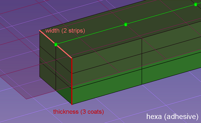

Hexa Realization Options
Figure 6.
| Option | Action |
| width | Define the width of the continuous hexa weld in the direction
perpendicular to the seam direction. Note: Only available for
hexa (adhesive) and hexa (RBE2-RBE3).
| strips | Define the number of hexa elements required along the width. |
| coats | Defines the number of hexa elements required along the thickness. |

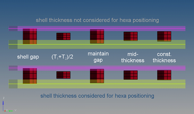

| thickness |
Select a method for defining the thickness of a hexa
weld.
Note:
![]() Figure 7. |

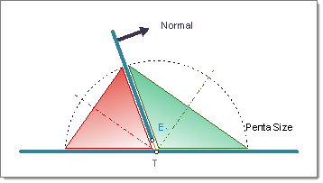

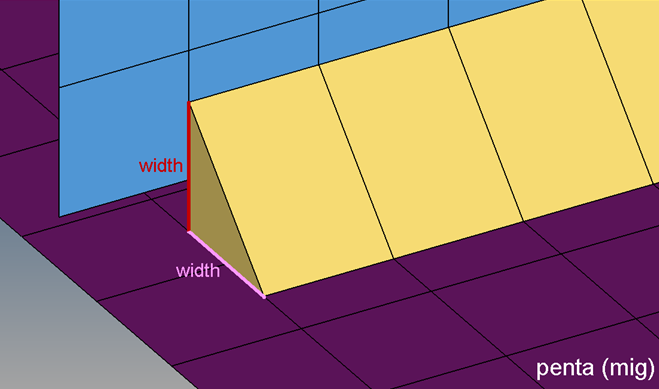

Penta Realization Options
Figure 11.
| Option | Action | ||||||

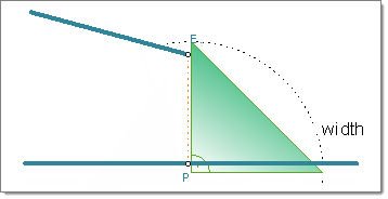

| width | Specify the length of a penta. Note: Only available for penta
(mig), penta (mig + L), penta (mig + T), and penta (mig +
B).
| fitted/equilateral/equilateral-fitted |
Select the size and shape
of a penta.
Note: Only available for penta (mig) and penta (mig + L).

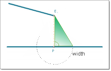

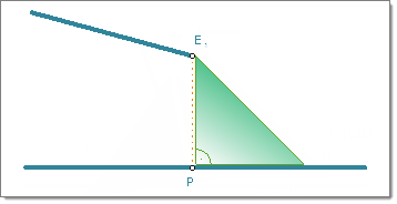

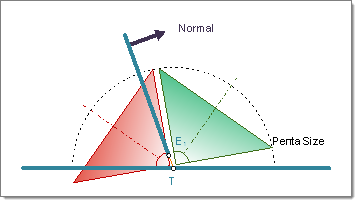

| right-angled |
Create a right-angled penta that is oriented around the
bisector. Clear this checkbox to create an angle adapted penta.
![]() Figure 15. Right-Angled T-weld Penta Created on Both Sides of the Normal ![]() Figure 16. Angle Adapted T-weld Penta Created on Both Sides of the Normal Note: Only available for penta (mig) and penta (mig + T).
| both sides/positive sides/negative sides |
Select which side of the normal to create
the penta on.
Note: Only available for penta (mig), penta (mig + L), penta
(mig + T), and penta (mig + B).

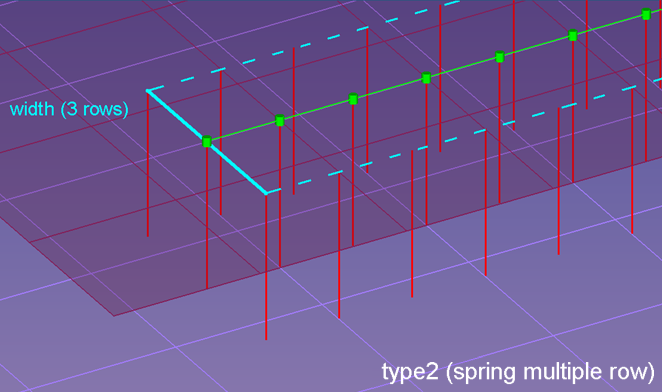

Other Seam Realization Options
Figure 20.
| Option | Action |
| row | Specify how many rows of spring elements have to be created. The rows are parallel to the seam connector. The rows are distributes equidistant through the width. |
| width | Specify the distance between the outermost element rows. |

| group/ungroup | Apply grouping or ungrouping to a set of connectors. |
