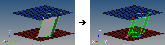

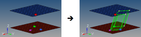

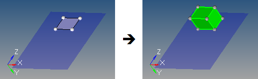

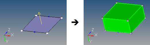

Block Subpanel
- base node
- Select the node that defines the first corner on the bottom face.
- node 1
- Select the node that defines the corner of the bottom face that indicates the depth.
- node 2
- Select the node that defines the corner of the bottom face that indicates the width.
- Node 3
- Select the node that defines the corner of the top face that indicates the height and angle.

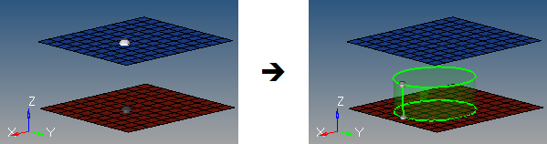

Cylinder Full Subpanel
Figure 3.
- bottom center node
- Select the node that defines the center of the bottom cylinder face.
- vector between the bottom center and normal vector node
- Select the vector that defines the cylinder axis, thereby defining the
cylinder orientation. Note: This does not indicate the actual cylinder height.
- base radius
- Specify the radius of the top and bottom cylinder faces.
- height
- Specify the cylinder height.

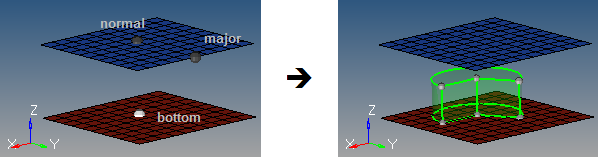

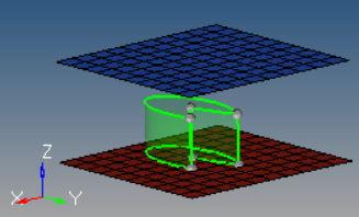

Cylinder Partial Subpanel
Figure 4.
- Select the vector that defines the cylinder axis, thereby indicating the cylinder orientation. This does not indicate the actual cylinder height.
- vector between the bottom center and major vector node
- Select the vector that defines the zero-degree point of an arc defining the curved surface of the partial cylinder. This arc extends in a direction based on the normal vector using the right-hand rule, with its start angle and end angle specified relative to this vector.
- base radius
- height
- start angle
- Specify the angle that defines the starting arc angle, measured from the major vector node in a direction based on the normal vector using the right-hand rule.
- end angle
- Specify the angle that defines the ending arc angle, measured from the major vector node in a direction based on the normal vector using the right-hand rule.
- axis ratio
- Specify the percentage of the major vector.

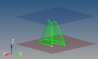

Cone Full Subpanel
Figure 6. Cone Full Example. The cone is created with a top radius of 1.0; if the radius had been 0, it would taper to a point instead.
- Select the node that defines the center of the bottom cone face.
- vector between the bottom center node and the normal vector node
- Select the vector that defines the cone axis, thereby indicating the cone orientation.
- top radius
- Specify the radius of the top cone face.
- base radius
- Specify the radius of the bottom cone face.
- height
- Specify the distance between the cone's base and its top.

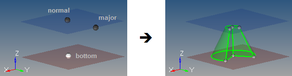

Cone Partial Subpanel
Figure 7.
- vector between the bottom center node and the major vector node
- Select the vector that defines the zero-degree point of an arc defining the curved surface of the partial cone. This arc extends in a direction based on the normal vector using the right-hand rule, with its start angle and end angle specified relative to this vector.
- top radius
- base radius
- height
- start angle
- Specify the starting arc angle, measured from the major vector node in a direction based on the normal vector using the right-hand rule.
- end angle
- Specify the ending arc angle, measured from the major vector node in a direction based on the normal vector using the right-hand rule.
- axis ratio

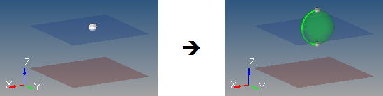

Sphere Center and Radius Subpanel
Figure 9.
- center node
- Select the node that defines the center of the sphere.
- radius
- Specify the sphere radius.

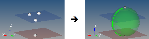

Sphere Four Nodes Subpanel
Figure 10.
The selected nodes cannot all be coplanar. The smallest sphere that passes through all four nodes is created. If more than four nodes are selected, only the four most recent are used.

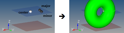

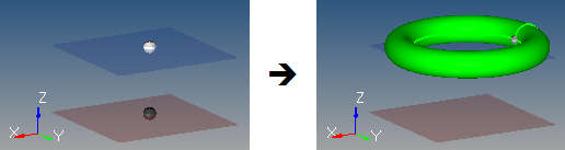

Torus Center and Radius Subpanel
Figure 11.
- center node
- Select the node that defines the center of the torus.
- vector between the center node and the normal vector node
- Select the vector that defines the torus axis, thereby defining the torus orientation.
- major radius
- Specify the outside radius of the torus, measured from the center node.
- minor radius
- Specify the radius of the circular cross-section of the torus.

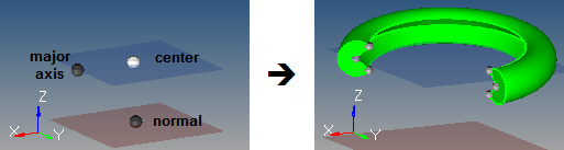

Torus Partial Subpanel
Figure 13. Torus with Partial Start and End Angles on Both the Major and Minor Radii. The partial major radius produces the broken/partial ring, while the partial minor radius produces the interior groove. The image of the torus is zoomed-in for better detail.
- center node
- Select the node that defines the absolute center of the torus.
- vector between the center node and the normal node
- Select the vector that defines the torus axis.
- vector from the center node to the major axis node
- Select the vector that completes the definition of the torus plane.
- major radius
- Specify the radius that defines the outside radius of the torus, measured from the center node.
- major start angle
- Specify the angle that defines the starting arc angle for the major circumference (ring), measured from the torus plane in a direction based on the torus axis using the right-hand rule.
- major end angle
- Specify the angle that defines the ending arc angle for the major circumference (ring), measured from the torus plane in a direction based on the torus axis using the right-hand rule.
- minor radius
- Specify the radius that defines the radius of the circular cross-section of the torus.
- minor start angle
- Specify the angle that defines the starting arc angle for the minor circumference (cross-section), measured from the mid-plane of the cross-section in a direction based on the cross-section centerline using the right-hand rule.
- minor end angle
- Specify the angle that defines the ending arc angle for the minor circumference (cross-section), measured from the mid-plane of the cross-section in a direction based on the cross-section centerline using the right-hand rule.

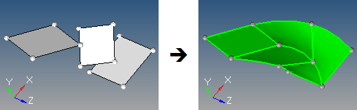

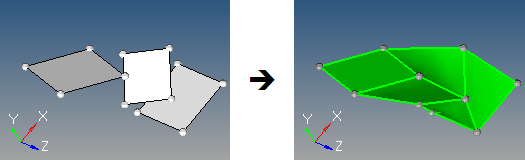

Bounding Surfaces Subpanel
Figure 14.
- surfaces
- Select the surfaces that define the continuous, closed shell. The surface selection must be completely closed; if the surface selection contains any free edges or gaps, a solid cannot be created.
- auto select solid surfaces
- Select a single surface, then automatically select the other surfaces that form a continuous shell.
- create in
- Choose a method for organizing the resulting solid body components.
- current component
- Organize the new solids and the selected surfaces to the current component.
- surfs component
- Organize the new solids to the same component that the selected surfaces already belong to. If the input surfaces are in different components, the result is not predictable.

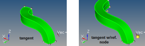

Figure 19. - line tangent
- In addition to the translation of the fixed frame option,
rotate the surfaces in the same way that the tangent of the
line list rotates.

- reference node and transformation plane
- S
- Start of drag line, which is the closest end of the line to the surface vertices.
- T
- Tangent of drag line at S.
- R
- Reference node.
- B
- Base node of the transformation plane.
- N
- Normal vector of the transformation plane.
- transformation plane
- Translate and rotate the input surfaces prior to the drag.
By default, no transformation occurs (B=R and N=T). If
specified, the surfaces are translated by the vector defined
from R to B, and are rotated from N to T.

Drag Along Normal Subpanel
Figure 24. Drag Along Normal Example. The yellow arrow displays once the surface is selected, and indicates the surface normal.
- surfaces
- Select the surface(s) to drag.
- keep connectivity
- Maintain the connectivity of the input surfaces to any attached surfaces. If the input surface is part of a solid, this must be enabled.
- merge solids at shared edges
- Create a single solid with merged faces created at the shared edge locations.
- create in
- Choose a method for organizing the resulting solids component.
- current component
- surfs component
- distance
- Specify the length to drag the surfaces along it normal.
- drag direction
- Define the direction of the drag.
- drag +
- Defined using the surface normal direction.
- drag -
- Defined in the opposite direction.

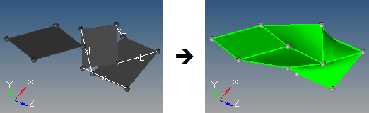

Ruled Linear Subpanel
Figure 25.
- surface list
- Select the surface list to use.
- create ring solid
- Consider the first and last surfaces in the list as a pair in order to form a closed loop solid.
- split solid at shared surfaces
- Split the solid at each of the input surfaces to create multiple solids with shared surfaces.
- create in
- current component
- surfs component

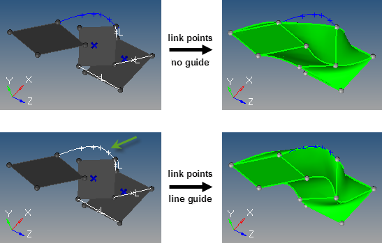

- link type
- Select whether user-defined links are used to provide better
interpolation and shape control.
- default
- Ignore user-defined links or guiding lines/surfaces.
Figure 26. - select links
- Define node/point links.

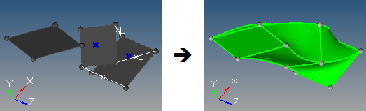

Ruled Smooth Subpanel
Figure 28.
- surface list
- Select a surface list to use.
- create ring solid
- create in
- current component
- surfs component
- link type
- default
Figure 29. - define links
- Define node/point links. Node/point links are input as pairs
since a link between input surfaces is specified by its two
end points/nodes. Furthermore, a pair may not skip any
surface in between. For instance, if surfaces 1, 2, 3 and 4
are defined in that order as the input surface list, a link
can be defined from surface 2 to 3 but not from surface 2 to
4. If such a link is detected, it is ignored. One point/node
may be linked to multiple points/nodes, which results in the
creation of triangular surfaces. Node/point links show
graphically as a white line between the pairs, with an L at
the line center. To disable a pre-defined link, right-click
the L graphic. To re-enable a disabled link, left-click the
L graphic.
