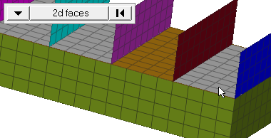

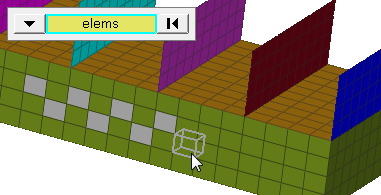

Elements Subpanel
Use the Elements subpanel to display and reverse the normals of elements. Select elements indirectly by components or directly by elements, or elect to have all of the displayed 2D elements selected automatically. Click display to review the current normal orientation of the selected elements. Optionally, click reverse to flip the normals to the opposite side (reverse the normals).
You can also use the Elements subpanel to adjust element normals. Select elements to adjust, then select an orientation method which determines how element normals are adjusted. When you are finished, click adjust. Optionally, select display adjusted only to only display the elements which have been adjusted in this operation. All elements selected for adjusting must be in a continuous mesh for this operation.

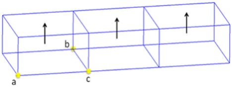

- by nodes on bottom face
- Selected elements will be adjusted by selecting the nodes on the bottom
face of one element. The stack direction will then point from the bottom
face to the opposite face of the element. For hexahedron elements, two
diagonal nodes or three nodes can be selected; for pentahedron elements
three nodes need to be selected. Note: Only works for multiple layers of elements.
Figure 6. Adjust Normal by Nodes on Bottom Face. Either two nodes a and b, or an additional node c can be selected to define the bottom face for a continuum shell element.
