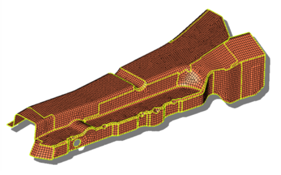

| merge small areas | Combine small areas;
for example, a long but narrow strip that might result in two
parallel feature lines very close to one another would instead
create only one feature line. The value you enter is the ratio
between areas of the feature patches that will be combined,
therefore the smaller the value entered, the more areas will be
combined.![]() Figure 4. Merge Small Areas Note: Only available when analysis type is set to
