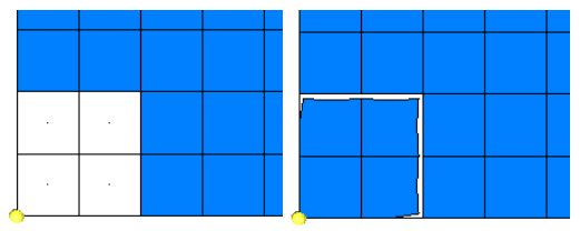

Figure 1. Detach Elements. In the first image, elements are selected. In the second image, the elements are detached and offset. The nodes defining the corner of the component were not moved.
