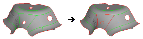

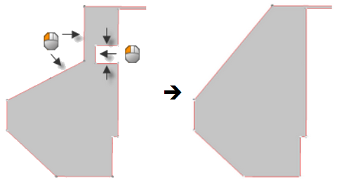

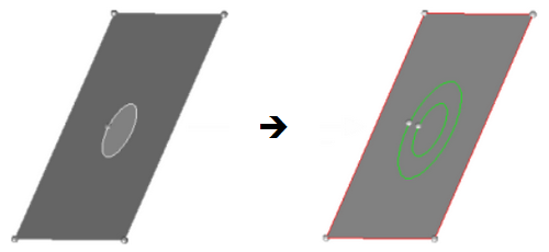

| at cursor: edge | Remove a single,
specific trim line.![]() Figure 8. . Clicking each of the circular trim lines (holes) removes the trim and extends the surface. |

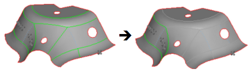

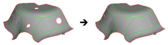

| all trim lines of surfs: surfs selector | Remove all of the trim
lines on one or more surfaces that are selected. ![]() Figure 9. . Selecting the front face surface trims all of its lines, including the one forming the hole in its center. |
| Selected trim lines of surfs: lines | Select trim lines so
that you can untrim portions of the surface.![]() Figure 10. Edges Selected. Arrows indicate selected edges. ![]() Figure 11. Edges Trimmed . Each selected edge is trimmed. |

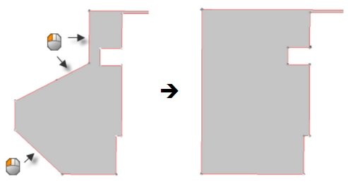

| internal trim lines: lines selector | Remove one or more
trim lines inside the boundaries of the surface selected. ![]() Figure 14. . Clicking each shared edge line removes it, stitching the adjacent surfaces. |

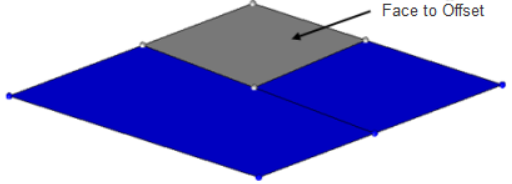

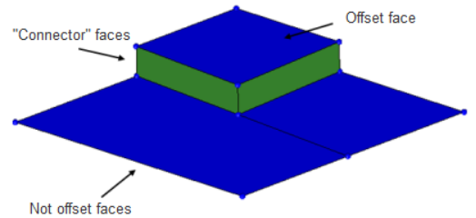

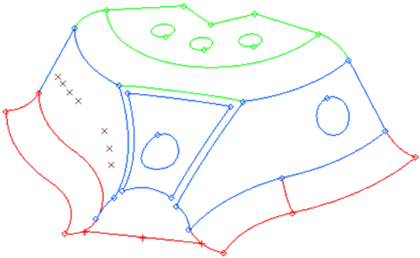

Use the Offset subpanel to offset a group of surfaces by a given distance along the normals of those surfaces. A negative offset value can be used to offset these surfaces in the opposite direction of the surface normal. The topology of the surface edges (free, shared edges, and so on) is maintained during the offset function. Some individual surfaces will be trimmed or extended to maintain the connectivity. This function moves the selected surfaces to the new location.
If you want to save the original surfaces, the selected surfaces can be duplicated before the offset. You can review the normal direction of the surfaces by clicking vector normal or color normal. If the offset direction is incorrect, the reverse normal function can be used to reverse the normal of a selected surface. If there are elements associated to the offset surfaces, the element will not move along with surfaces. The association between the elements and their surfaces is broken.

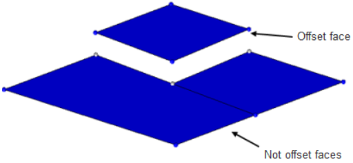

Figure 15. No Offset Performed on Surface
Figure 16. Disjointed Surface

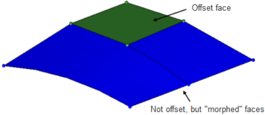

Figure 17. Offset using the Continuous Option
Figure 18. Offset using the Continuous Option, with Separator Lines Specified. Separator lines are specified at the edges of the offset surface.

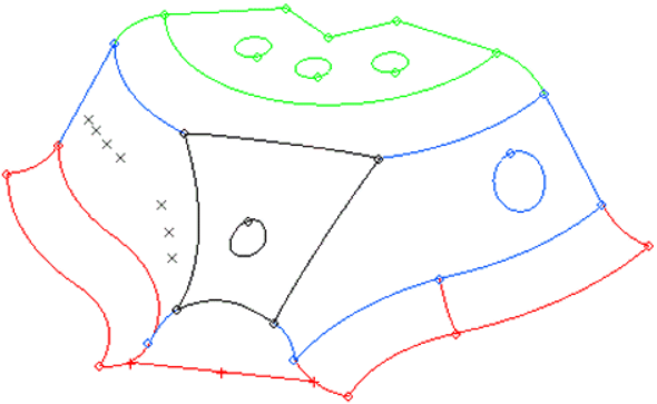

When this checkbox is enabled and the selected surfaces extend through their target surfaces, or even merely to the interior without actually touching any of the target surface edges, the surfaces will be both trimmed and stitched at the intersection regardless of whether or not they belong to the same component. However, when this checkbox is cleared, the surfaces are not trimmed or stitched, since they do not meet at any edges. |
Shrink Subpanel

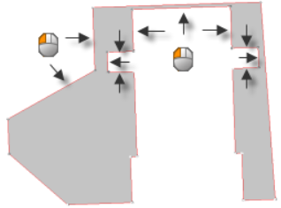

Use the Shrink subpanel to shrink the surface by drawing all of its edges (including internal edges from holes, and so on) back away from their starting location.
Figure 20. Surface Before Shrinking. The black surface has been selected.
Figure 21. Surface After Shrinking. The edges of the selected surface pull inward, away from the initial edge locations.
