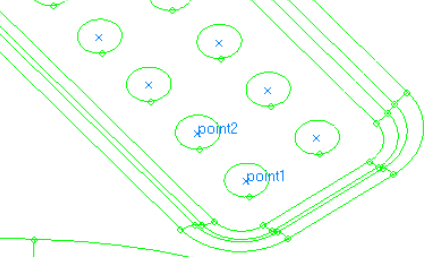

Distance between Two Nodes
Figure 1. Distance between Two Nodes

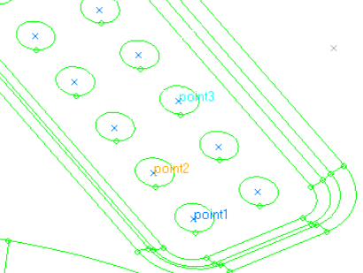

Distance between Three Points
Figure 2. Distance between Three Points
