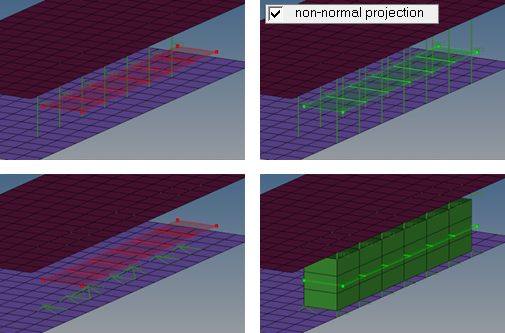

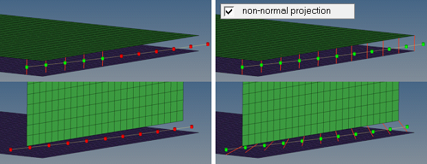

| non-normal projection | Waive the requirement for a normal projection to enable link
candidates to only be found within the connector
tolerance. Typically the link detection requires a valid normal projection to the link candidates (note that an angle of <5° will be considered as normal). If the normal projection is not possible, the realization fails. By default this option is disabled for spots. ![]() Figure 2. |

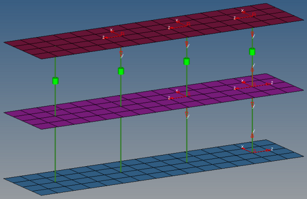

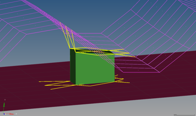

| system definition | Allow the creation of coordinate systems along with the
creation of simple 1D FE representations. The y-axis is
collinear with the 1D element the system is located at.
![]() Figure 3. |

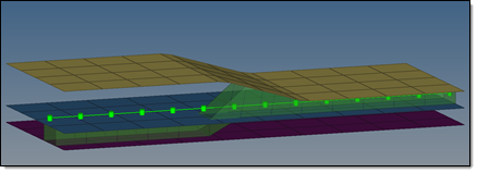

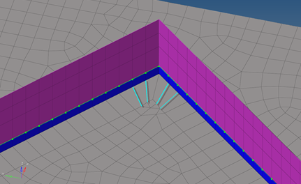

| use normal direction of the closest element to determine links | Add links to spot connectors based on the normal direction of
the closest element. This option is useful when there are a
lot of small components, which may result in the wrong
components being determined links.
![]() Figure 4. |

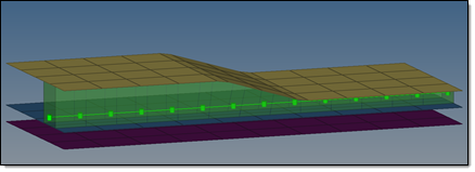

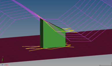

| orthogonal faces 1 hexa acm | Create ACM hexa elements as orthogonal as possible. This option overrules the normal shell gap
option.
Figure 5. If project hexa faces to shell is also enabled, the shell gap will be forced and, at a minimum,
the hexa edges for each hexa pointing from one link to the
next will be parallel to each other.
![]() Figure 6. |

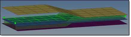

| project hexa faces to shell | Investigate and project each individual node, enabling you to
expect and accept penetrations.![]() Figure 7. ![]() Figure 8. |

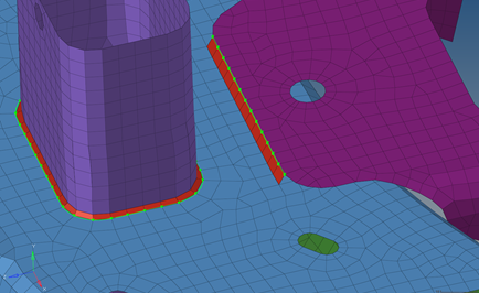

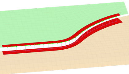

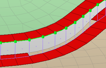

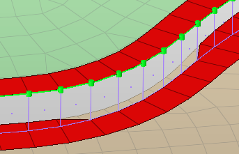

| sliver elements at free edges | Select how to manage sliver elements in your model that have
an element length less than the value specified in the element
length field, and that are located at free edges. Sliver elements are small elements that you may not want in your model. In the images below, a perfect perpendicular
projection resulted in sliver elements. The red elements
represent the HAZ elements.
![]() Figure 11. Allow ![]() Figure 12. Prevent by Moving Projection Points ![]() Figure 13. Prevent by Moving Edge ![]() Figure 14. Delete Sliver Elements |

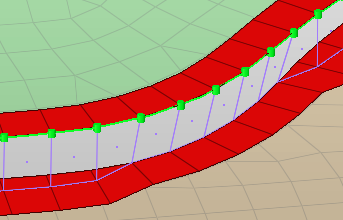

| washer preservation | Select how to modify washer elements close to seams.![]() Figure 15. Washer Elements Example. Washer elements are colored green.

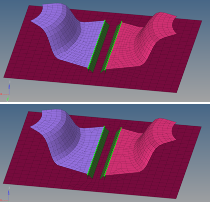

| don't share zone elements | Prevent the sharing of zone elements. To generate seam
welds with the desired size of imprinted elements, even if
the seam welds are close to each other, imprinted elements
can be shared among two connectors.
![]() Figure 19. |

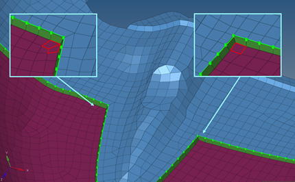

| max quadsize reduction in % | Specify the maximum deviation from the requested imprint quad
element size. By default, this value is set to 30.0%. It can
be set from 5.0% to 80.0%.
![]() Figure 20. |
| max quadskew in degrees | Specify the maximum deviation from an ideal right angled
quad. By default, this value is set to 30.0°. It can be set
from 5.0° to 45.0°.
![]() Figure 21. |

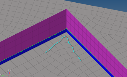

| corner quads | If seams are not smooth and contain vertices, a different
mesh pattern in those corner may be requested.
![]() Figure 22. |

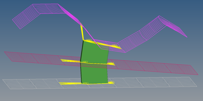

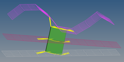

Figure 26. Consider Shell Thickness and Offset for Solid Positioning Disabled. Hexas are positioned around the midplane between the mesh.
Figure 27. Consider Shell Thickness and Offset for Solid Positioning Enabled. Hexas are exactly positioned around the mid air gap. - Lap Connections
