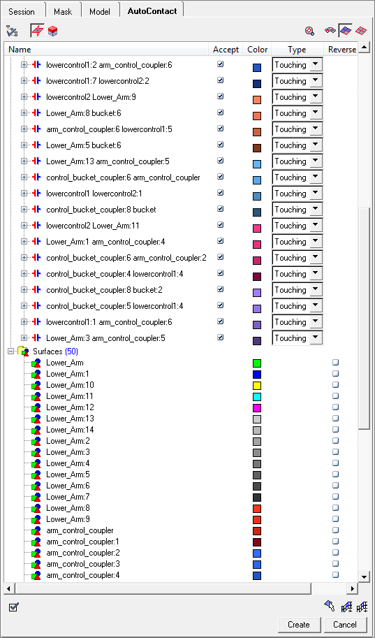

Auto Contact Browser
The Auto Contact Browser provides options for reviewing and modifying contact interfaces and surfaces that the Auto Contact tool finds.
Auto Contact Browser Columns
| Column | Description |
| Name | Lists the names of all of the contact interfaces and surfaces
found by the Auto Contact tool. Underneath each contact interface name is the temporary master and slave surfaces associated to that interface. Red indicates a slave surface, and blue indicates a master surface. Renaming entities, as well as Master/Slave surface swapping is possible via the context menu. |
| Accept | This checkbox defines whether or not a contact interface is included in the creation process once you click Create. |
| Color | Color that is assigned to the contacts and contact surface entities. |
| Type | Type of CONTACT assigned to each contact interface. This affects the IGLUE option for the given BCBODY-BSURF pair inside the BCTABLE card. |
| Reverse Normal | This checkbox defines whether or not the normal direction of the given surface should be reversed or not. When OFF (default), surfaces on 3D elements point outwards, and surfaces on 2D elements point in the direction of the element normal. |

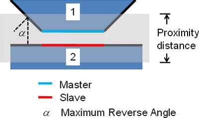

Click Proceed and enter two values in the Auto
Contact dialog.
- For Proximity distance, enter a value to specify the maximum proximity distance between the components of contact pairs.
- For Max reverse angle, enter a value to specify the maximum angle between the normals of two elements or element faces within the proximity distance. If this value is exceeded, the element is not included in the contact. The default value is 15 deg.
Figure 2. Definition of Proximity Distance and Maximum Reverse Angle -

The status bar activates. Once it is complete, the Auto Contact Browser automatically opens.
Use the Auto Contact Browser to review all of the found interfaces and make any
necessary adjustments to your contacts and contact surfaces. When you are
finished, click Create.
Contact pairs are created for all items marked as Accepted. Clicking Cancel will close the Auto Contact Browser without creating any contacts.This creates a BCTABLE card with master-slave entities that use the contact types displayed in the Auto Contact Browser.
