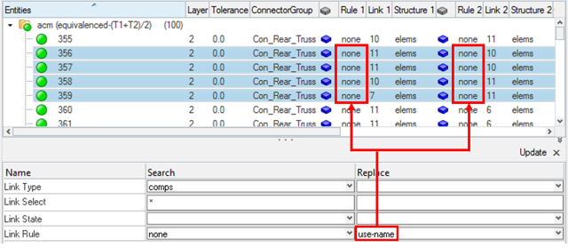

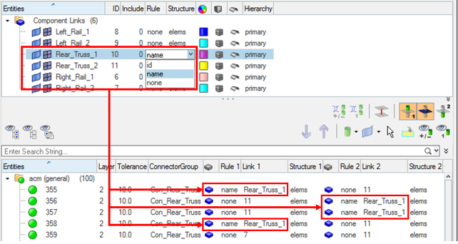

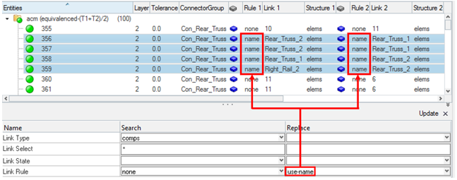

Update Link by Directly Editing Column Data in the Connector Browser
