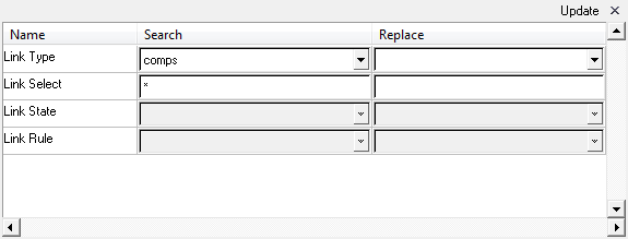

| Update Link | Opens a new set of controls in the bottom of the tab to
perform a part replacement. Note: Editing a connector causes it
to become unrealized.
