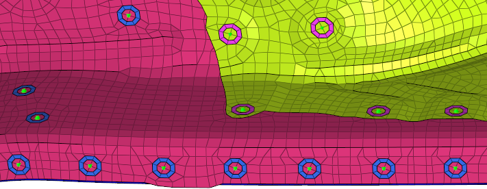

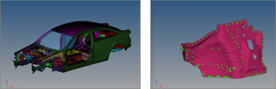

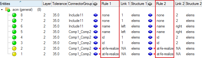

- Show Link Rule Columns
- When enabled, each link displays its reconnection rule (use ID, use
name, or at fe realize) via the Rule column. The reconnect rule is set
when the connector is created, and determines what the connector will
automatically try to reconnect with when a part is deleted and then
replaced.
- If the new part has the same part ID as the deleted one, then use ID will automatically reconnect.
- If the new part has the same name as the deleted one, then use name will automatically reconnect.

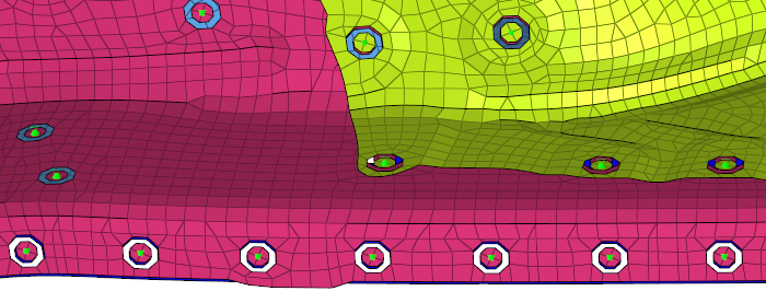

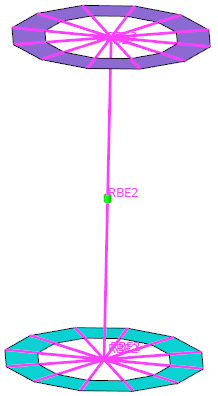

Figure 1. - Show Link Elems/Geom Columns

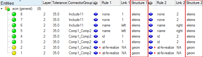

- When enabled, each link displays its link state (connect to mesh or
geometry) via the Elems/Geom column.

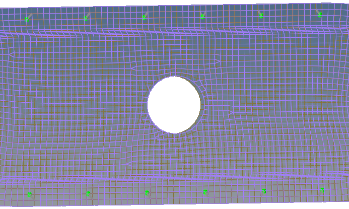

Figure 2. - Max Link Column Viewed
- Only display the specified number of columns, regardless of how many links are available in a connector. The maximum number of supported columns is 30.

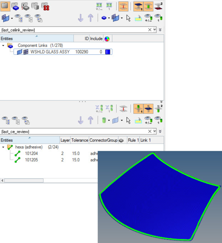

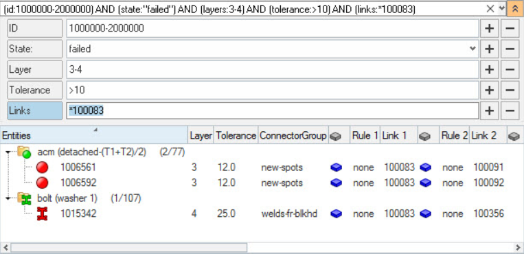

- Automatic Filter
- Filter the link entity list and the connector list simultaneously when
performing a show, isolate, or find operation.

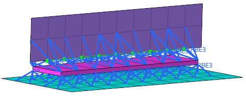

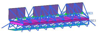

Figure 3. Isolation of the Windshield Glass Components with Attached Connectors. The strings entered in the Query Builder (last_celink_review) and (last_ce_review) illustrate that the lists have been filtered. - Consider Geometry

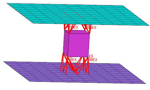

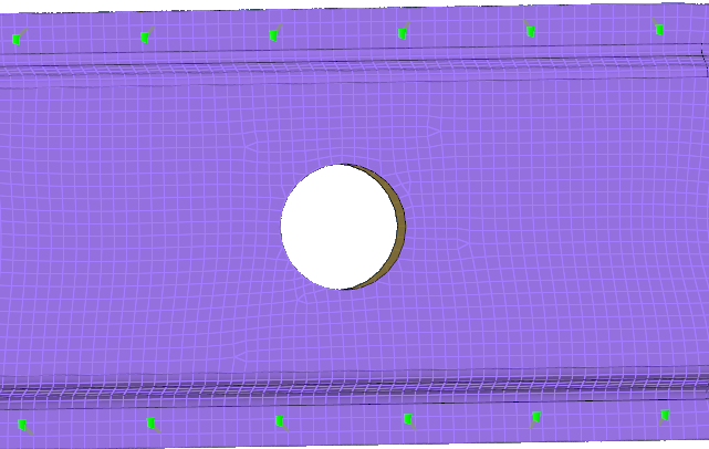

- Consider geometry along with elements while using Show/Hide/Isolate
operations.
Figure 5. Consider Geometry: Off
Figure 6. Consider Geometry: On - Consider HAZ Elements

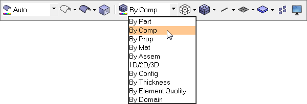

- With this mode activated, the Connector Browser
takes over the control of the element visualization mode from the
Visualization panel. Elements will be colored by component, by property,
or by part, depending on which connector link view is activated.
