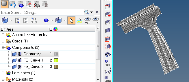

Action Mode Tools
Use the action mode tools, on the right side of the Model Browser, to control both entity selection and the display of the model.
Entity Type
The Entity Type tool (
) sets
functions as a "mode" selector for the rest of the tools by determining what type of entity
the remaining tools will act on.
For example, if you set the Entity Type to "components", the Selector will only select or deselect components.
) to
open the Entity Type drop-down menu and then select the desired entity type.

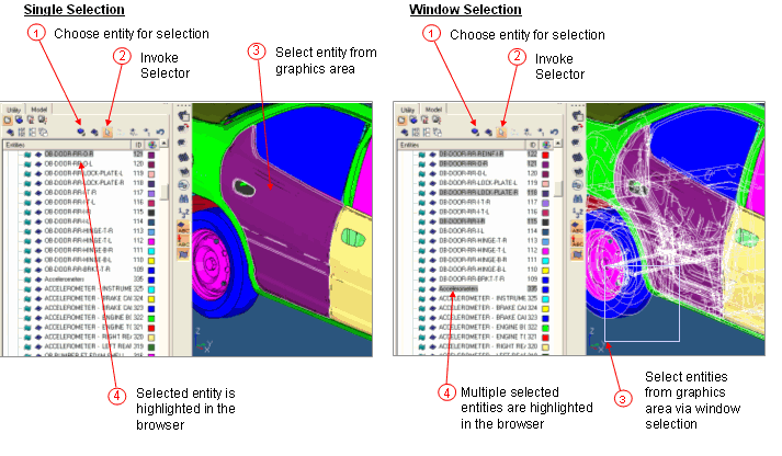

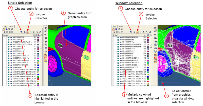

Selector
Use the selector (
) to
interactively select supported entities from either the Model Browser or from within the graphics area.
Figure 4.
Figure 5.
Figure 6.
Change the Selection in the Graphics Area Using the Mouse Scroll Wheel
In a Microsoft Windows environment, you can also use a scroll-wheel-equipped mouse to "drill down" through the model and select parts that may not be immediately visible.
Select Entities in the Graphics Area
- Left-click to select entities.
- Left-click and hold to pre-highlight entities; the entity under the selector at any given moment highlights, but is not selected until you release the mouse button.
- Shift + left-click to use window selection to highlight or select multiple entities.
- Right-click an entity to deselect it.
- Control + right-click to use window selection to deselect multiple entities.

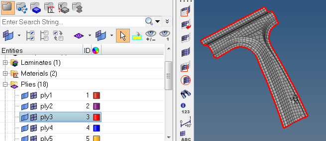

Select Entities in the Model Browser Tree List
- Left-click to select and highlight an entity in the browser – the entity is also highlighted in graphics area.
- Control + left-click to select multiple entities in both the browser and graphics area. Multiple entities of the same type can be appended to the selection. Left-click can be used to add/remove components from an active collector on a pane.
- Shift + left-click highlights multiple entities in the browser and the graphics area. You can append and remove entities from a panel's active collector list depending on which entity entry is selected.

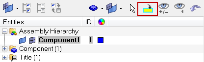

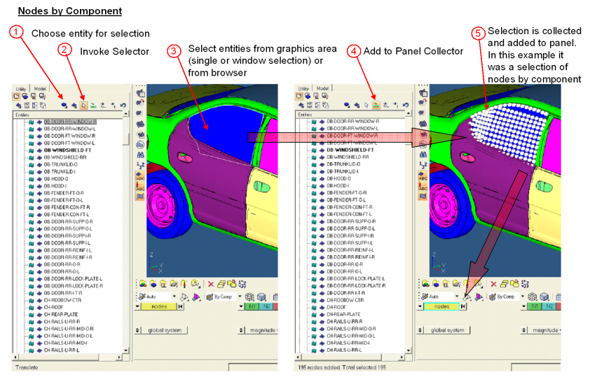

Add to Panel Collector
The Add to Panel Collector (
is a function whereby the browser can be used to select and add entities to the panel
collectors.
Figure 9.
There are two ways of using this tool:

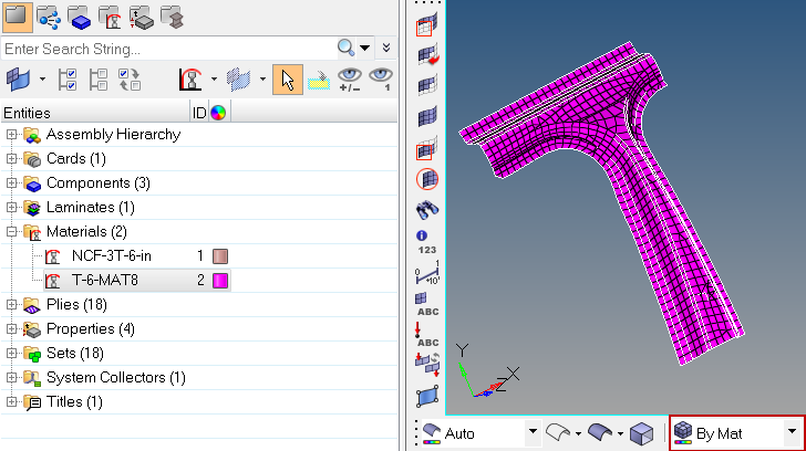

When you select materials and properties, the Visualization mode will change to by Mat and by Prop respectively. However, no graphics highlighting of material or properties occurs when using the selector.

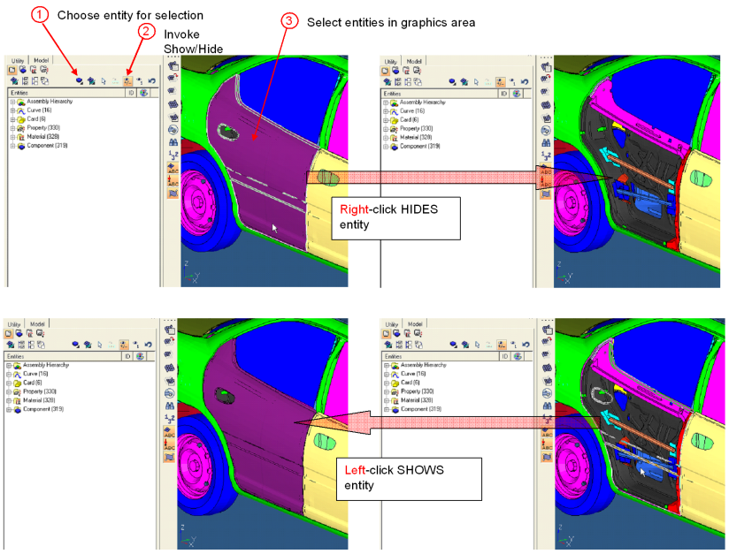

Pick in Graphics
- Left-click turns on entities to the display that are currently turned off.
- Left-click-and-drag pre-highlights only the entities that are currently turned off in the display (entities already turned on do not highlight).
- Right-click turns off entities in the display.
- Right-click-and-drag pre-highlights only the entities that are currently turned on in the display (entities already turned off do not highlight.)

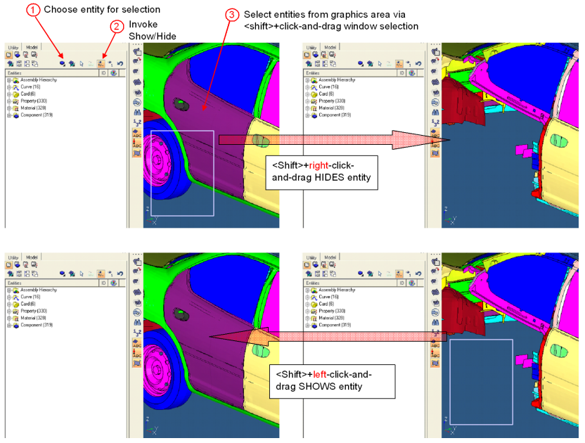

Single Selection
Figure 11.
- Shift + left-click-and-drag uses window selection to turn on multiple entities in the display.
- Shift + right-click-and-drag uses window selection to turn off multiple entities in the display.

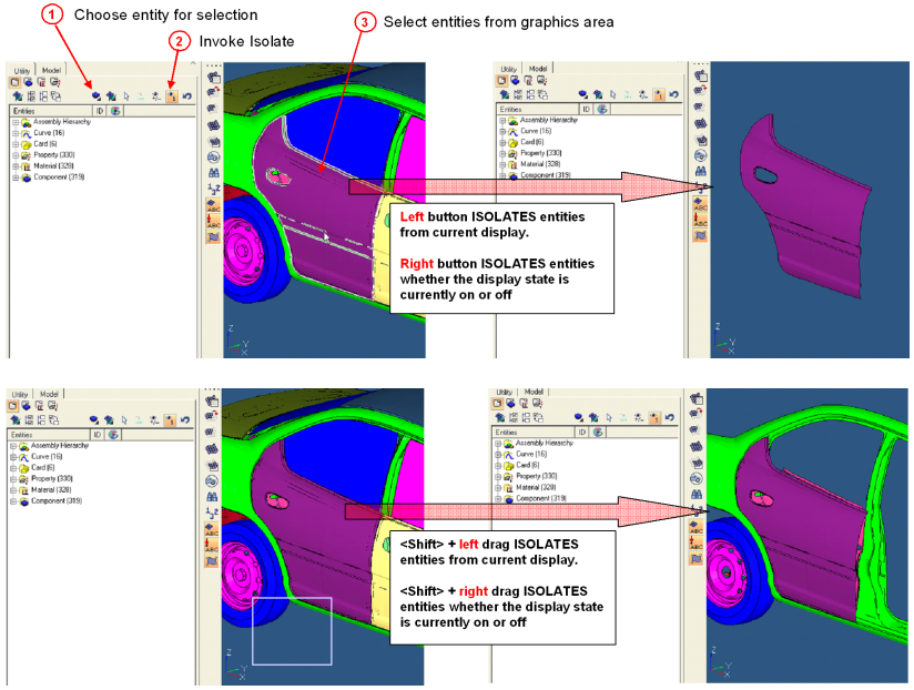

Isolate
Use Isolate (
) to only display
the selected entity in the graphics area and Model Browser.
Using the selector may give you more precise control over which entities to retain – but for simple isolation tasks, direct usage of the Isolate button is generally quicker.
Similar to the selector tool, you can change your selection in the graphics area using the mouse scroll-wheel for the Isolate Shown/Isolate Not Shown tools. To isolate entities that are shown, left-click, hold, and scroll. To isolate entities that are not shown, right-click, hold, and scroll.
Pick in Graphics
- Left-click will isolate the selected entity from those on display (single-click selection).
- Left-click-and-drag will pre-highlight entities that are currently displayed. It will not highlight entities that are currently turned off in the display. Upon release, the pre-highlighted entity will be isolated.
- Shift + left-click-and-drag uses window selection to isolate multiple entities (but only entities currently visible).
- Right-click will isolate entities from all available entities, whether currently on or off in display.
- Right-click-and-drag will pre-highlight an entity that is displayed or turned off from the display in the graphics area. Upon release, the pre-highlighted entity will be turned on and isolated.
- Shift + right-click-and-drag uses window selection to isolate entities from all available entities, whether displayed or turned off from the display.
Single and Window Selection
Figure 13.
