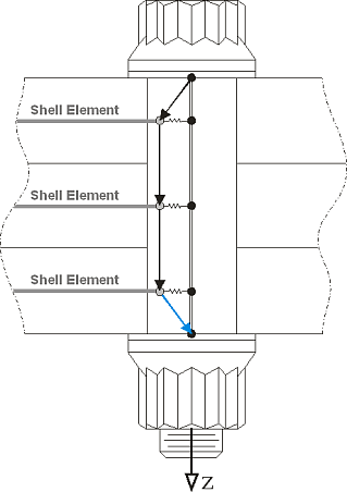

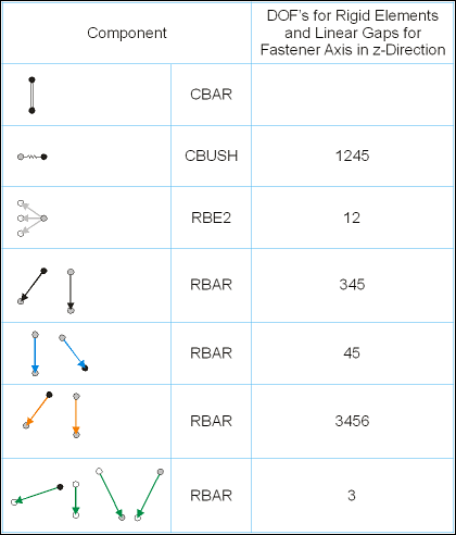

The HiLock realization type can be used for any more or less parallel combination of PSHELL and PCOMP elements, and creates a 1D element construct consisting of RBAR, CBAR and CBUSH elements.
The outer extensions represent the thicknesses of the outer shell elements. The inner nodes of the RBAR element are connected to the shell elements whereas the inner nodes of the CBAR elements are coincident to the shell nodes. Between the appropriate connected and coincident nodes CBUSH elements are created. Each outer node connects one CBAR and one RBAR.
Each HiLock connection gets its own coordinate system with the z-axis collinear to the HiLock direction. All affected nodes are assigned to this coordinate system, which is taken into account for the DOF definition of the CBAR elements, the stiffness calculation of the CBUSH elements, and the DOF of the node constraint.

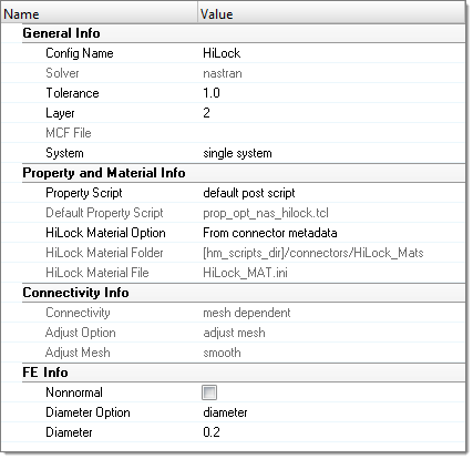

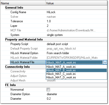

HiLock Material Option
When defining a HiLock connector, the HiLock Material Option can be selected for individual connectors using the Connector Entity Editor.
- From current model
- Select an existing material from the current model.
- From search folder (default)
- For HiLock realizations the material search folder is HiLock_Mats.
HyperMesh searches for this folder in
the following locations and in the following order:
- Installation: [hm_scripts_dir]/connectors/Hilock_Mats
- User directory: [USER_HOME]/HiLock_Mats
- HyperWorks Configuration Path folder: [HW_CONFIG_PATH]/Hilock_Mats
- Current working folder: [CURRENTWORKINGDIR]/HiLock_Mats
- From connector metadata
- Once a connector is realized with the HiLock Material Option “From Search Folder”, the folder and file name is written as metadata to the connector. Folder data is saved in a relative manner to allow the exact same rerealization in a different work environment as long as the materials are saved in according folders.

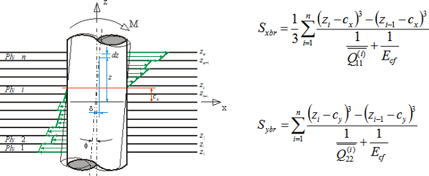

Calculation of Bearing Stiffness in Composite Parts
- Combined translational bearing stiffness at composite plate with the fastener contact
- These values are defined for every composite plate in the joint.
- Combined translational bearing stiffness of the joint at ply i location in directions x and y

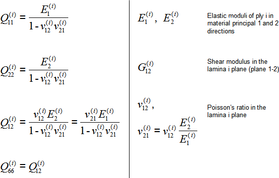

- Transformed reduced stiffness in x and y-direction for ply i

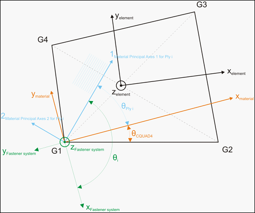

Where,
(theta = angle of orientation for ply i)
- Nonzero components of the reduced stiffness matrix for ply i
(1)

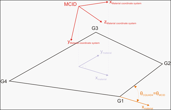

- Angle of ply i orientation in a CQUAD4 element
Figure 5. - Material orientation of a CQUAD4 defined by a coordinate system
Figure 6. - Rotational bearing stiffness in plate-fastener contact
Figure 7.
