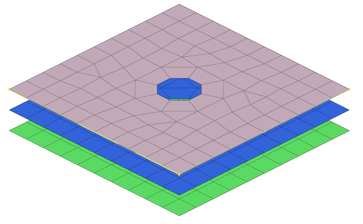

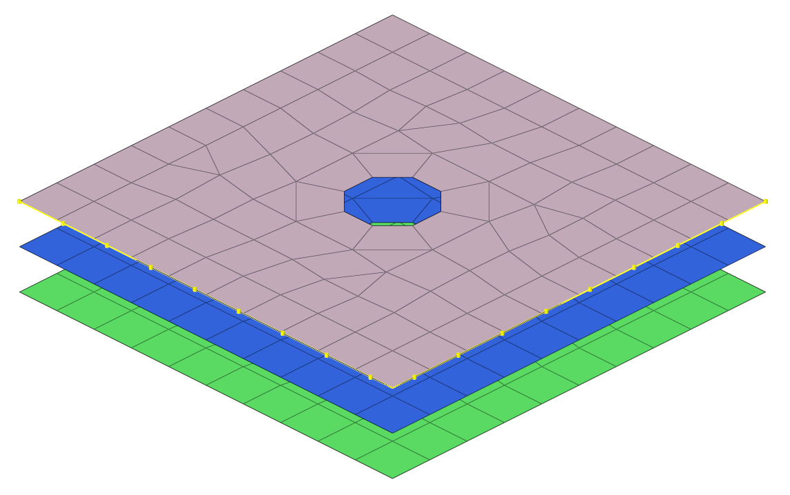

Historically, the connector spot lines and seam lines have contained a test point distributed evenly between the start and the end points of the line. This, however, would mean that the test points could lie between a corner, and as a result the corner would be missed. Connector lines now allow the connector to create Significant Points between features of the lines – for example, corners. The connector then interprets the test points between the significant points.
