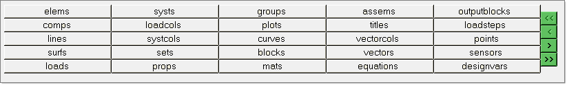

Page Menu
Figure 1. Default HyperWorks Page Menu

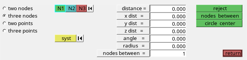

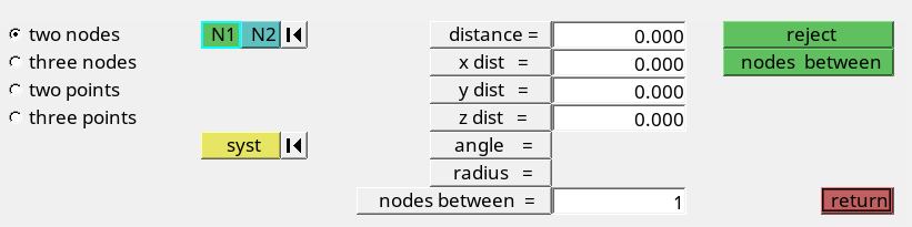

Subpanel
Figure 2. Distance Panel, Two Nodes Subpanel
Figure 3. Distance Panel, Three Nodes Subpanel
To select a subpanel, click the radio button next to the subpanel name on the left side of the panel.

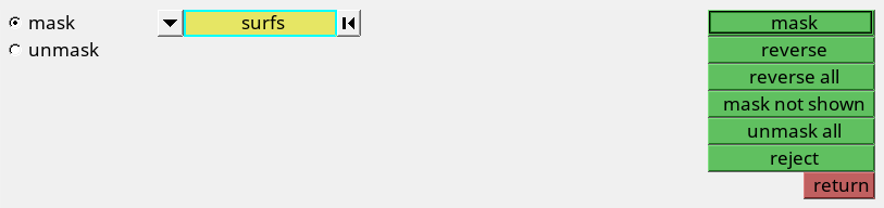

Rapid Menu
Figure 4. Mask Panel. The mask action is performed when you click the middle mouse button.
