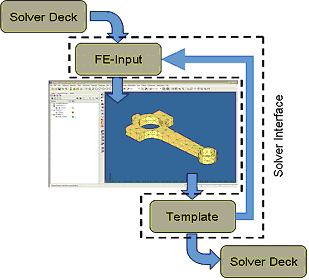

Solver Interfaces
Figure 1. Schematic of the Solver Interfacing Architecture
Templates
| MAT1 | MID | E | G | NU | RHO | A | TREF | GE | |
| ST | SC | SS |
The HyperWorks material named entity has data names of name and ID. Therefore the template would also have to define attributes for E, G, NU, RHO, A, TREF, GE, ST, SC, and SS in order to completely define and store the OptiStruct MAT1 solver card within a HyperWorks material named entity with a MAT1 card image. Templates define attributes using the *defineattribute() command. The example template code uses the *defineattribute() command to define these attributes.
In order to associate the OptiStruct MAT1 solver card to the HyperWorks material named entity with a MAT1 card image the template would contain a *materials(MAT1) definition block to define this association. Within the *materials(MAT1) definition block a MAT1 card image would be defined using a *beginmenu() definition block . This *beginmenu() definition block is read every time a materials named entity with a MAT1 card image is card edited using the card editor within HyperWorks. In addition, an export format for the OptiStruct MAT1 solver card would be defined using a *format() definition block within the *materials(MAT1) definition block. This *format() definition block is read every time an export of the HyperWorks database is requested which contains a materials named entity with a MAT1 card image. Example template code which performs these definitions for the OptiStruct MAT1 solver card is given.

FE-Input Readers
FE-input readers perform the function of reading solver decks and importing solver cards into the appropriate entities with the appropriate card images, data names, and attributes set as defined by the template. Furthermore, FE-input readers require template attribute definitions to perform their tasks.
In the FE-Input code example below, you can find this example template code in [Install Directory]\hm\examples\feinput\ExampleFEInput.cxx.
