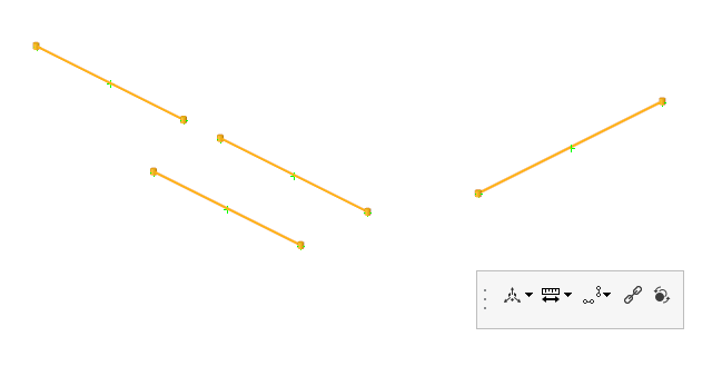

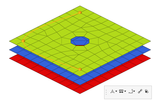

Line Interpolation - Straight line (
) - A straight interpolation line is created between the
selected nodes.
Figure 1. - Interpolated line (
) - A smoothed interpolation line is created between the
selected nodes.

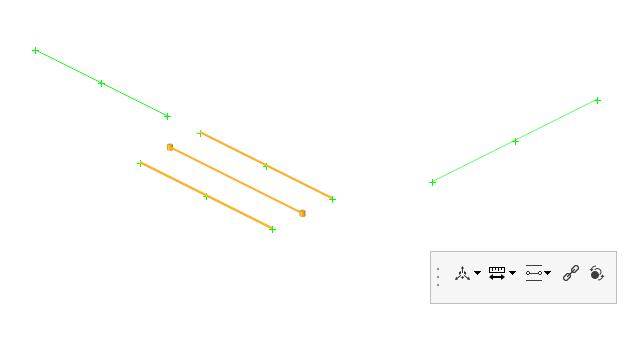

Line Creation - None (
) - Leave the line selections separate.

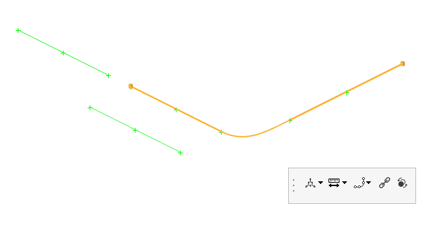

Figure 3. - Combine Smooth (
) - Combine selected lines with an interpolated line.
Figure 4. - Combine Straight (
) - Combine selected lines with a straight line.

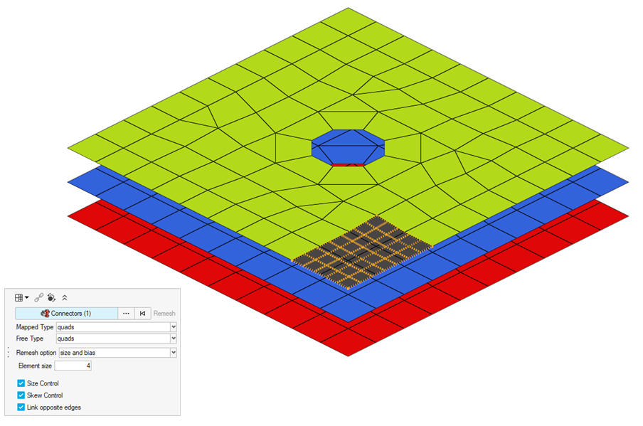

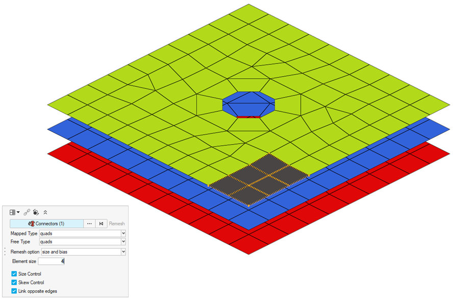

Remesh (
)Remesh the connector surface.
Figure 7.
Available for any selection type in the Area tool.
