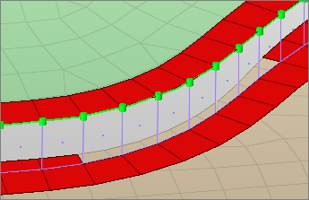

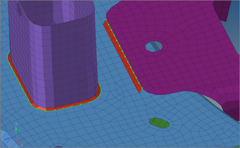

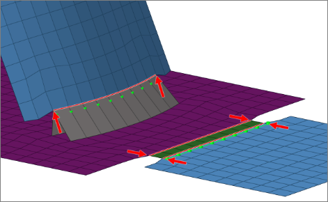

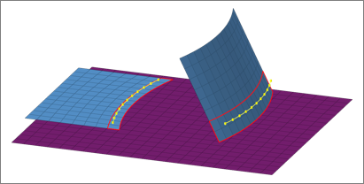

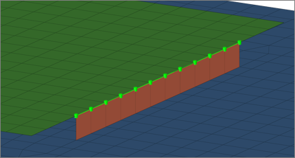

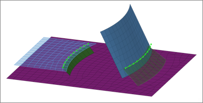

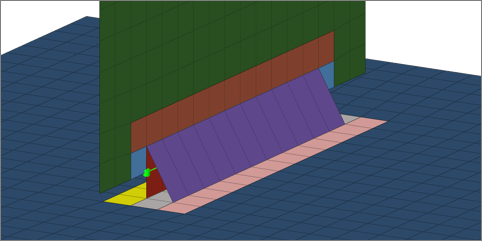

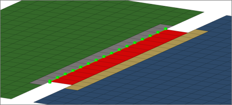

The seam-quad LTB realization serves and realizes t-welds, lap-welds, and butt-welds
simultaneously.
This weld type is identified automatically based on the orientation of the links to
each other.
The dimensions and properties assigned to all heat affected zones (HAZ) can be
defined separately. Normal directions of quad weld elements and HAZ elements can be
controlled. An edge treatment can be defined for t-welds and butt-welds to move the
edge a precise distance from the opposite link. Figure 1. Seam-Quad LTB

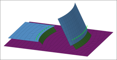

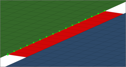

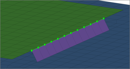

Weld Shape
T Weld Shape
Defines how the T weld is created.
Figure 5. Vertical T weld
Figure 6. Angled T weld
Figure 7. Vertical and angled T weld
L Weld Shape
Defines how the L weld is created.
Figure 8. Vertical L weld
Figure 9. Angled L weld
Figure 10. Vertical and angled L weld
B Weld Shape
B welds are always created in a straight manner. Figure 11. Straight B weld

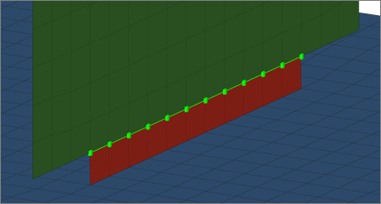

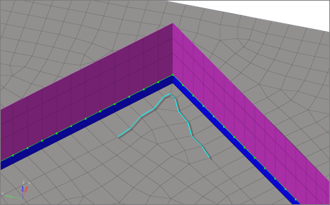

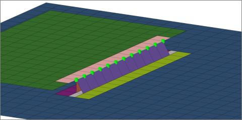

With Caps
When enabled, seams are closed with a tria element.
The Caps settings determines how the caps are created.
Figure 12. Tria cap element for T weld
Figure 13. Tria cap element for L weld

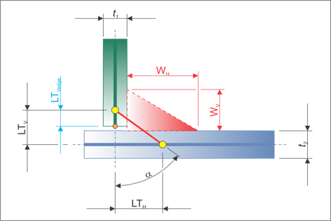

The Realization Details settings position the yellow marked nodes in the Figure 14, Figure 15, and Figure 16.
Figure 14. T Dimensions
Figure 15. L Dimensions
Figure 16. B Dimensions
The dimension of the welds are dependent on the Weld Shape settings.
Dimensioning Scheme
Defines the dimensioning scheme for the dimensions of the T weld, L
weld, and B weld connections.
input
Manually define discrete values for the weld dimensions,
shown in black in Figure 14, Figure 15, and Figure 16, with the exception of thickness. The
horizontal dimensions can be defined using a length or an
angle.
thickness dependent
Choose a formula to define the weld dimensions, shown in
provided formulas are all dependent on the thicknesses t1
and t2. A formula can be chosen individually for each
verticalV and horizontalH distance, or the same formula can
be used for T, L and B.
weldsize dependent
shown in red in the Figure 14, Figure 15, and Figure 16. The verticalV and horizontalH distances
are defined with formulas reflecting the weld sizes and the
t1 and t2 thicknesses.
DIM T (Dimensioning T)
Input
Thickness dependent
Weldsize dependent
Horizontal Lengths LTH
by angle
by length
(t1+t2)/2
3*(t1+t2)/2
t1+t2
t1/2+wh/2 (fix)
Vertical Length LTV
by length
by edge
(t1+t2)/2
3*(t1+t2)/2
t1+t2
by edge
t2/2+wv/2
by edge

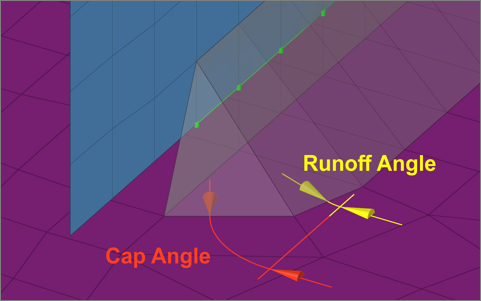

Caps
Determines how caps are created. Figure 17. Cap Angle and Runoff Angle
Figure 18. Sharp Corner Enabled
Figure 19. Sharp Corner Disabled
Element Details

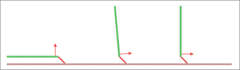

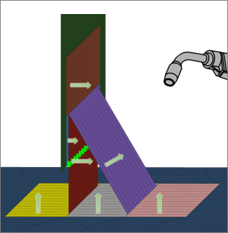

The Element Details settings control the normal directions of the weld, as well as
the HAZ elements.
Vertical Element Normal, Angled Element Normal, and HAZ Element Normal can be set to either:
Towards welder
Shows the normal directions
Away from welder
Shows the exact opposite.
Figure 20. Towards welder
Figure 21. Away from welder

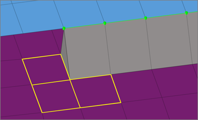

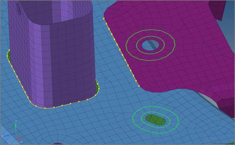

Connectivity Info

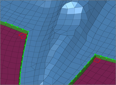

imprint (default)
Creates quad weld elements, and stitches them to both links by adjusting
their mesh. All required HAZ are performed.
skip imprint
Creates quad weld elements, but does not change the meshes of the links.
Instead, additional elements are created to represent the requested HAZ.
These elements are organized in the ^conn_imprint component, and can
later be used for a manual imprint after they have been manipulated to
the users needs. This option can be helpful when working with more
complex areas, where the standard imprint functionality fails, for
example, conflicting connectors.

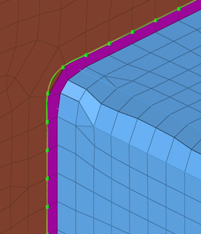

imprint/no HAZ
their mesh. Mesh modifications are as minimal as possible, and no HAZ
are performed.
none
Creates quad weld elements only. Quad weld elements will not be attached
to the links. The connection will need further attention.

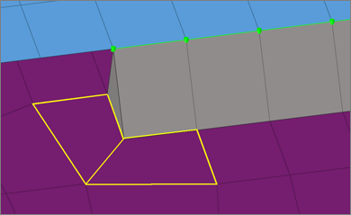

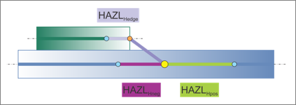

HAZ Info

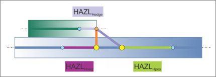

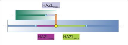

The HAZ Info settings define the lengths of the different heat affected zones (HAZ),
which are dependent on the HAZ lengths for T, L and B (defined in Realization Details). The
HAZ length settings vary depending on the defined weld shapes (vertical, angled,
vertical and angled, caps).
HAZ Scheme
Choose a dimensioning scheme for the HAZ lengths of T, L, and B.
input
Enables you to decide if the HAZ lengths should be defined
individually, or if all HAZ lengths are determined using the
same approach (same as all).
weldsize dependent
Only available if weldsize dependent has been chosen for the
Dimensioning Scheme as well.
HAZ Lengths
same as all
Assigns the same length to all HAZ lengths.
individual
Assign HAZ lengths individually.
HAZ Lengths (various)
The following options are available in the various
HAZ length settings.
input
Requires a discrete value be specified for the length.
average meshsize
Length is dependent on the average mesh size in the local
area where the imprint is performed.
by thickness
Sets the length to the same value as the thickness of the
link getting the HAZ.
LTH
Horizontal length for T connections, which is the length
between the foot points of the vertical and angled part of a
seam.
LLH
Horizontal length for L connections, which is the length
seam.
LB
Butt weld length.
skip HAZ
Skips individual HAZ that are not required.
same as positive side
Assigns the same length as the positive side to the negative
side.
wh or wh/2
Length is dependent on the horizontal weld size. Only
available when HAZ Scheme is set to weldsize dependent.
wv or wv/2
Length is dependent on the vertical weld size. Only
wb or wb/2
Length is dependent on the butt weld size. Only available
LTVedge
Choose between skip HAZ and LTVedge. Only available for
the HAZTvedge length.
HAZ Length Factor (Avg. Meshsize/Thickness)
Factor that increases or decreases the HAZ lengths, which have been
defined using the average meshsize or by thickness length options.
Max HAZ Length
Maximum length for all HAZ lengths. If the HAZ length is greater than
this value, then the Max HAZ Length is used.

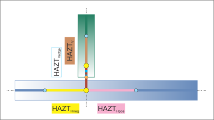

Dimensioning and Heat Affected Zones (HAZ):
Dimensioning T
Figure 22. Dimensioning T
Figure 23. Vertical T Weld HAZ
Figure 24. Angled T Weld HAZ
Figure 25. Vertical and Angled T Weld HAZ

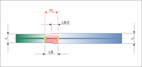

Dimensioning B
Figure 30. Dimensioning B Figure 31. Straight B Weld HAZ

components.
select
Select a property from the current model via the Select
Property For HAZ option. Unless direct property assignment
is activated, a component named ltb_seam_quad_haz_ with the
property ID as a postfix is created.
same as original
Assigns HAZ elements the same property as the original. No
further properties are created. HAZ elements are organized
into components named ltb_seam_quad_haz_ with the property
ID as postfix.
scaled original thickness
Creates a new property and component for each link that has
a HAZ imprinted.
The property is a copy of the original. Properties are named
as ltb_seam_quad_haz_<linkname>_<scaled thickness>,
and components are named the same as the properties.
In addition, you can define the following:
HAZ thickness factor
Enables entering a factor to scale the
thickness.
HAZ Property Grouping
Groups properties in order to reduce the amount
of properties created.
Do not group
Prevents grouping.
group same thickness
Groups HAZ elements with the same thickness
into one property and component. HAZ elements of
T, L, and B welds are also grouped together if
they have the same thickness.
ltb_seam_quad_haz_<scaled thickness> or
ltb_seam_quad_haz_<property ID>, and components
use the same name as properties.
group same thickness within T, L, and B
Groups all HAZ elements with the same
thickness into one property and component, as long
as they have the same weld type of T, L, B.
Properties are named ltb_seam_quad_<t or l
or b>_<thickness>, and components use the same
name as properties.
input thickness
a HAZ imprinted.
ltb_seam_quad_haz_<linkname>_<scaled thickness>, and
HAZ thickness
Enables a factor for thickness to be
entered.
do not group
Prevents grouping.
thickness into one property and component. HAZ
elements of T, L, and B welds are also grouped
together if they have the same thickness.
Properties are named as
Within T, L, and B groups all HAZ elements
with the same thickness into one property and
component as long as they have the same weld type
of T, L, B.
Properties are named as ltb_seam_quad_<t or
l or b>_<thickness>, and components use the
Guarantees the HAZ on the positive and negative side of the
T or L weld are assigned the same property.
same as the other size
Guarantees the HAZ on both sides of the B weld are assigned
the same property.

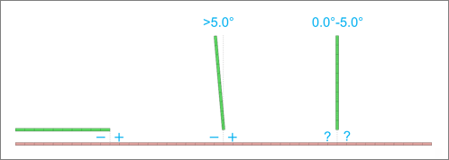

positive side/negative side
The positive and negative side can be determined as long as
the links are not perfectly perpendicular to each other. Figure 32. . Overview of how the positive and negative side is
determined. When links are perfectly perpendicular,
the edge quad normal option is automatically
used.
edge quad normal
Figure 33. . Overview of how the side for the angled weld is
determined. If the normal directions are reversed,
the side of the angled weld changes.

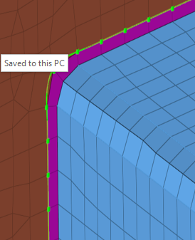

Preserve Washer
Controls how washers are preserved during the seam imprint
realization.
Figure 39. Original Mode with Perfectly Meshed
Washers
Figure 40. No Washer Preservation Enabled. Washers have been opened.
Figure 41. Washer Preservation and Remesh Enabled. Washers are still intact, but the mesh seeding has
been modified.
Figure 42. Washer Preservation and No Remesh Enabled. The washers have been fully preserved.

Quad In Corner
Controls whether a single or double element is created in corners of
quad seam connectors with a certain vertex.
A angle must be defined for a single quad corner. If the corner angle is
greater than the defined angle, a double quad corner is created. Figure 43. Quad in Corner. A double quad corner is shown on the right, and a single quad
corner is shown on the left.

Silver Elements
Sliver elements are small elements that you may not want in your model.
In the images below, a perfect perpendicular projection resulted in
sliver elements. The Sliver Elements setting can be used to manage
sliver elements in your model. In the images below, the red elements

Seam Loose Ends
A local option set on individual connectors. Enabling “Seam Test Points
Alignment” will also enable this option, which allows for the alignment
of start and end points of seam connectors along with alignment of other
test points.
Seam Fixed
A local option set on individual connectors. Enabling the “Seam Fixed”
option considers all the test points of seam connectors as fixed and
will not be disturbed.
Seam Consider Feature and Boundaries
A local option set on individual connectors. Enabling the "Seam Consider
Feature and Boundaries" option will adjust test points so the
projections fall on features/boundaries wherever possible. Overhanging
test points will be trimmed. Figure 50. Without Seam Consider Feature and Boundary Figure 51. With Seam Consider Feature and Boundary
