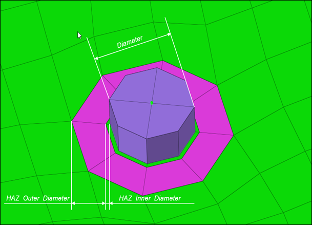

Figure 1. HAZ Dimensions

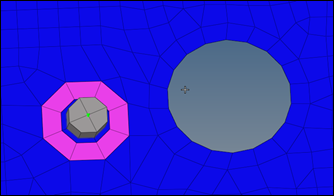

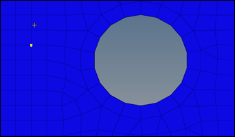

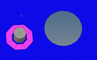

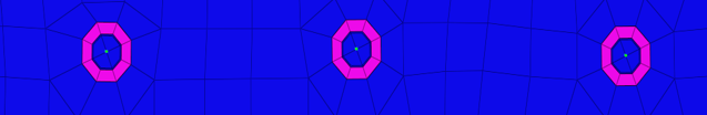

Preserve Washer | Choose a method for preserving washers during the
realization. Initial situation with perfectly meshed
washers.![]() Figure 2. Original ![]() Figure 3. No Washer Preservation ![]() Figure 4. Preserve Washer, Allow Remesh ![]() Figure 5. Preserve Washer, No Remesh |
